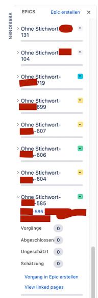

Now, the issue I have is that it doesn't seem to display Epics correctly. They will look like this:
I have multiple issues here, I will use one list item for each problem that I encountered:
  • As you can see, the name of the epic is not correctly displayed, as for some reason the Labels+ ticket no. are used ("Ohne Stichwort" = "no label").
  • Also, Tickets which are part of the same project and therefore also displayed in that board are not linked to the Epics (All Epics have 0 issues in them).
  • It also displays closed epics, but this is something we could solve with a different filter query.
  • I cannot change the name of these Epics. If I change them and reload the page, the old name is back. I can't even delete them, as opening them leads me to the original epic

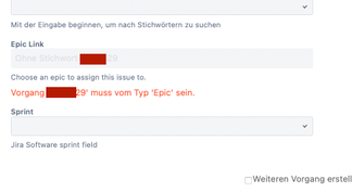

  • When creating a new issue in an existing epic, Jira tells me that "Issue XX-29 needs to be of type epic", but it also won't let me change the epic link:

What am I doing wrong? I assume the issue here is that Jira is cloning the epics, but not the tickets, so they already have Epics linked. Ideally, I would like to have the same view as in Project Boards, with the epic labels visible in each story/task card - Whether I can see the epics on the board doesn't matter to me. How can I achieve that?

Hi Michael. Thanks for taking your time to help! I think I didn't clearly communicate what I need and what the issue is.
With "project = XXX" I will see the epics in the new board, in the sidebar. But they have different names to the original board and don't have any issues attached, like in the first screenshot I sent. They will have their original label Number, but all of them are called "No-Label-345" for example
Even though in the original board the issues are linked to epics, if I look at them on the board I don't see the Epic label on the card. I would like to see that and also have all the other functions (e.g. Usable Epic Sidebar)
