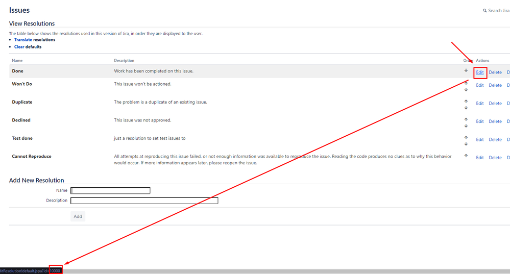

Kian is correct, an alternative way ( And I found it easier) is to:
  • go to the Cog icon --> Issues.
  • In the left menu, go to the lower part and found "Resolutions"
  • Hover over the Edit button on the Action Column and check the last part of the URL, check picture below for reference:
Hope this answer your question.
Cheers,
Nico.
Kian Stack Mumo Systems
August 22, 2022
@Nicolas Tagle
Just to clarify, what you've provided here would be the preferred solution if you are an administrator in the system. For users that are not administrators, they'll need to view the underlying issue data to gather the resolution ID's.
Nicolas Tagle
August 22, 2022
Hi Kian, that is correct. Since I saw the url provided within jiraadmin I don't think it would be a problem.
August 23, 2022
@Nicolas Tagle, I believe the question specified that the OP was not an admin which is why I recommended what I did. Either way, your solution is the best way admins can see the ID's.

frank lohfeld
August 23, 2022
oh - cool it works also.
I'm a admin, but not a Systemadministratorin - it means - I can't access the databases directly.
Thanks for your helpful awnser

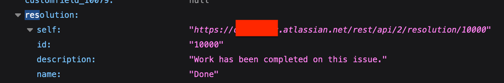

August 19, 2022
@frank lohfeld
You can view the JSON data of an existing resolved ticket using the url https://<your-domain>.atlassian.net/rest/api/2/issue/<your-resolved-issue-key>.
Once you have the JSON data, search for the "resolution" field.

frank lohfeld
August 20, 2022
Thank you very much - it works
