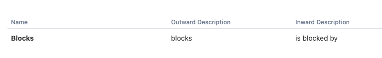

The Issue Linked trigger is triggered for the issue that gets the Outward Description portion of the link.
if ISSUE-A is blocked by ISSUE-B, this rule will execute on ISSUE-B.
If you looked at the details of ISSUE-B you would see under the Links section:
blocks
-- ISSUE-A
The Outward Description (blocks) of the link relationship appears in ISSUE-B's details, so the triggering issue for the rule is ISSUE-B.
The link you create between the story and the feature needs to result in the Feature issue details showing the Outward Description of the link relationship.
