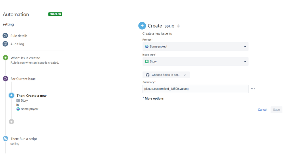

Hi dear all,
I need to create an automation which summary gets values from "Customers" custom field values. For instance if it has 300 different customers names, so the automation must create 300 issues. The other purpose is if a new values coming to this custom field, the automation must create new issue, otherwise it will not create new one.
I really appreciate if you help me on this problem.
Thanks in advance!
BR/ Anar

Thanks a lot for your response. Yes I used smart values for setting summary but it does not work.

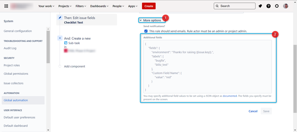

Can you once try using the additional fields option which will be available under more options as shown below.
If this solution not works I will suggest you to raise a ticket in atlassian they will help you with this requirement.

Thanks bro. But as I mentioned before if there is 300 values in single select custom fields the automation must create 300 different issues and must set the values to the summary in every issue. I am considering I need to write script for the solution.
