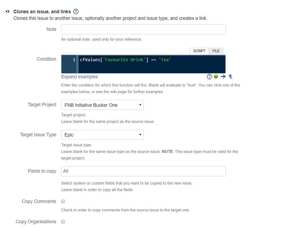

I would like to automatically create an epic based on the story transition.  The story contains a multiselect field called favourite drink.
When a user selects a the option 'Tea', the epic should be automatically created in the Tea Project and when the user selects the option 'Coffee', the epic should be automatically created in the Coffee Project.
I tried to use ScriptRunner build in scripts but no luck. For testing purposes, I automatically created a story on the Tea project when the 'Tea' option is selected and it works well. But not working for the Epic.  I think the reason it may not be working is due to the Epic Name field not completed (I could be wrong)

What is the error you see in the log files? Is it due to an mandatory field like "Epic name" which you have to set while creating an epic. And if that's the case then you need to set that value in "Additional issue actions"

It's due to setting the Epic Name.

In the "additional issue action" section you have to write this code, there are some sample already for "Set custom field" (click on expand examples)
def cf = customFieldManager.getCustomFieldObjects(issue).find {it.name == 'Epic Name'}
issue.setCustomFieldValue(cf, 'my value')
And place this post-function the last post-function field of the transition. (After "generic event" fired transition).
