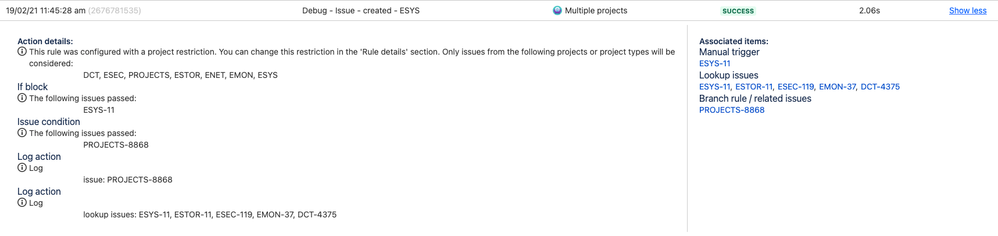

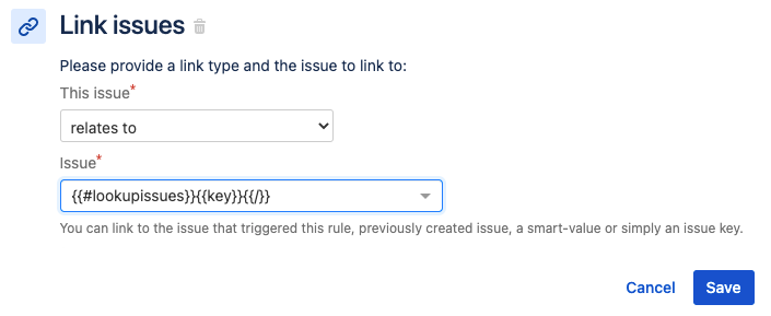

I've been able to retrieve the appropriate issues and they're stored in the {{lookupissues}} smart value, but how do I get them linked?  Would the Link Issues component work?
Thanks,
Paul
Bill Sheboy
February 19, 2021
Hi @Paul Benati
I don't that structure will work because Link Issues is expecting on key, not a list.
  • When you use a branch, you may process each issue, one by one
  • When you use Lookup Issues, you process them as a set.  For example with a math operation or when you want to send one email with a list of issues.
You will probably want to change your branch to use JQL that satisfies all of your criteria, and then link.

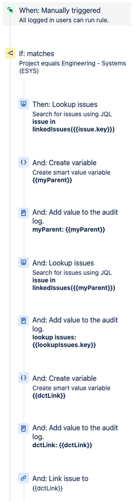

Paul Benati
February 19, 2021
All,
Okay, I figured it out.  No branching required!
[Note: for testing purposes, I used a manual trigger.]
Steps (check out the attached for details)
  1. Trigger = Issue created [Note:  this would be for one of the child issues.]
  2. Use a Lookup issues command to find the parent of the issue
  3. Create a variable to store the key of the parent (e.g., {{myParent}})
  4. Use Lookup issues commands to find each possible sibling.  In this example, EMON-3, ENET-14, & DCT-72.
  5. Use a match() to find each one
  6. Use a Link issue command to link the child to each of its siblings
Like Bill Sheboy likes this

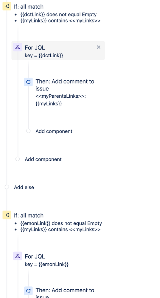

Paul Benati
February 23, 2021 edited
Bill,

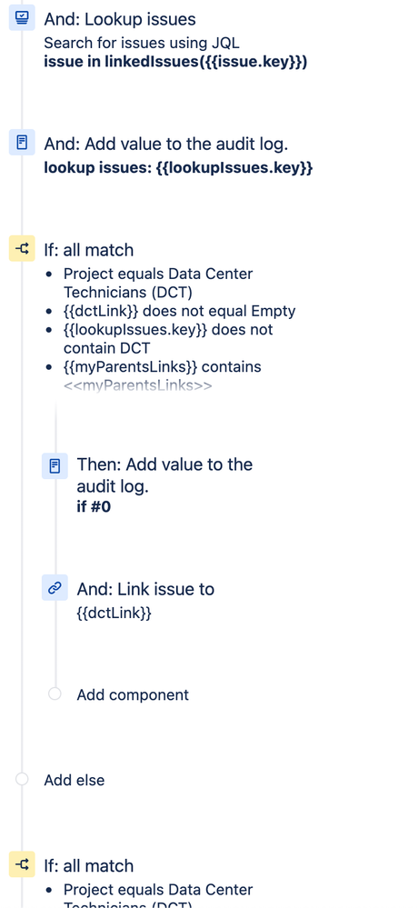

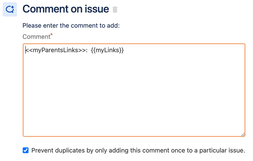

Any thoughts on how to prevent the same sibling from linking multiple times?  I'm doing a check prior to linking to see if the sibling is already linked, but I believe the asynchronous nature of the executions is tripping this effort up.
What if I added a re-fetch command after each "Link issue to" command as shown in the last image?
Note:  the two automatons below are triggered by Comments.  The second image shows the comment payload for the 2nd automation.
2021-02-23_09-15-08.png 2021-02-23_09-15-30.png 2021-02-23_09-16-27.png Thanks,
Paul
Bill Sheboy
February 23, 2021
Hi, Paul.
With the potential for parallel rule execution you will not be able to solve the timing issue with the re-fetch in this case.  For example, the re-fetch might occur just a moment before it is needed to solve the duplication problem.
Four potential approaches to "solve" this are:
  • Don't solve it: ignore and accept potential duplicate links
  • Create a chain of rules, such that each successive rule triggers the next.  This seems like a brittle solution to me.
  • Add logic to remove extra links.  This is really complicated and may not work for your case.  (I did this for labels and components, but there weren't parallel running rules.)
  • Pause, and re-think the problem you are solving.  For example, why is it important that the child issues are cross-linked when they have the parent to connect them?  Considering that answer may lead you to a different strategy.
Best regards,
Bill

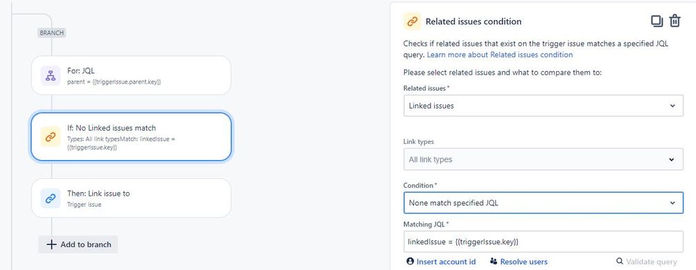

@Paul Benati @Martin Cleaver @Bill Sheboy I too had the same problem of duplicate links while linking all child issues. This is how I solved it and it works like a charm:
