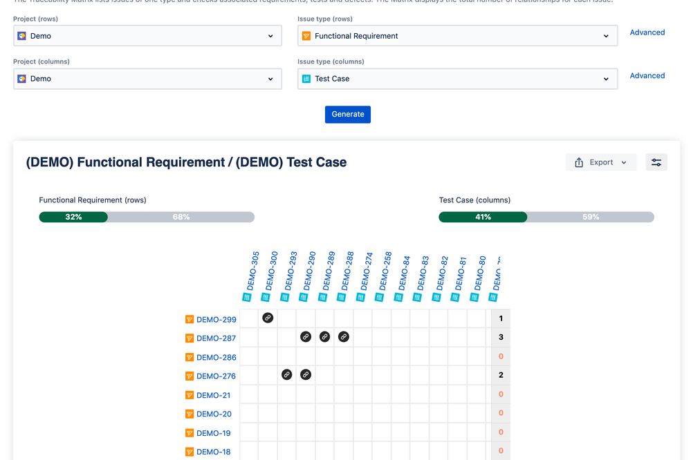

you can't do it by default in Jira.
You can provide it with Requirements and Test Management for Jira (which is also called RTM).
There is much more than only traceability matrix. You can also arrange whole testing process inside Jira, starting with writing requirements, ending at executions and reporting them.
Here is screen from traceability matrix you are looking for.
