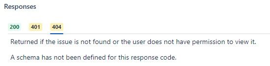

The screenshot below is from the documentation.
To confirm that you have access to the issue, with Jira open in a browser window, open another tab and combine your baseURL with rest/api/3/issue/pijd-7 and confirm that it returns the issue details correctly.
