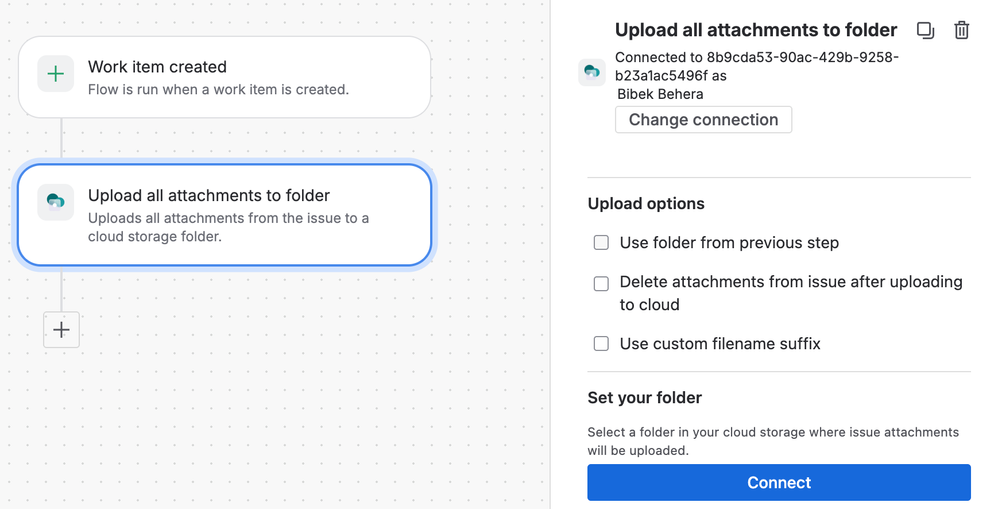

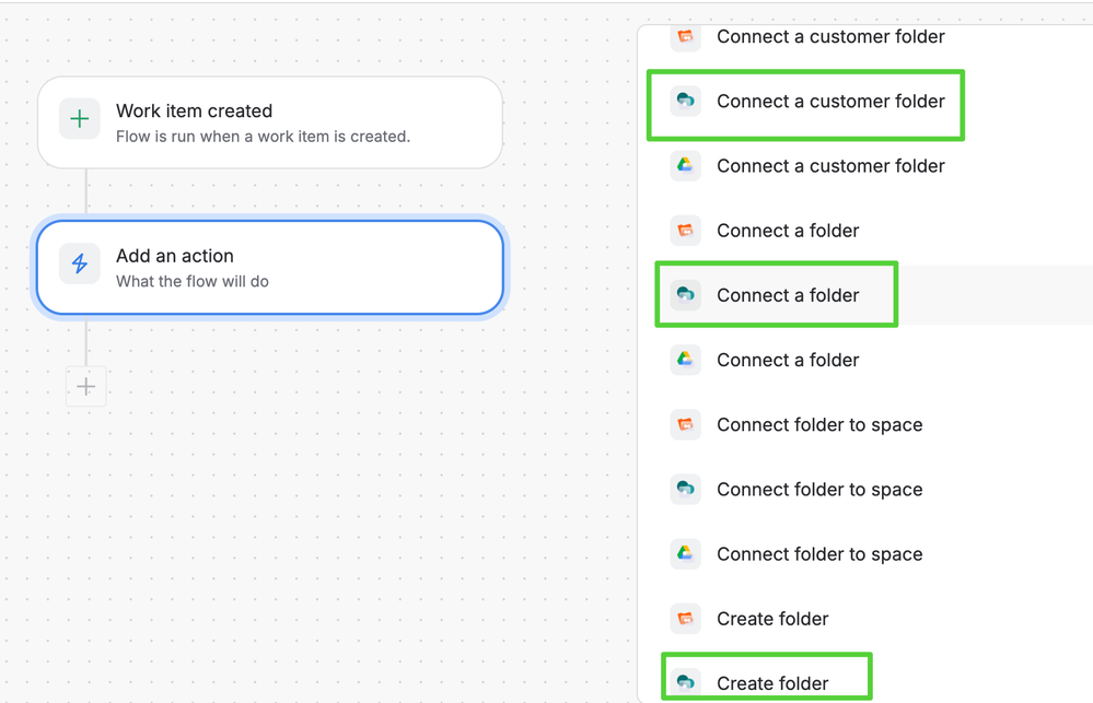

Hello @Md_ Abrarul Huda ,
I would suggest to explore Sharepoint Connector Automation for Jira . The connected folder's data will be available in the view work item screen itself.
You can use automation sharepoint triggers based on your use case.
-Bibek

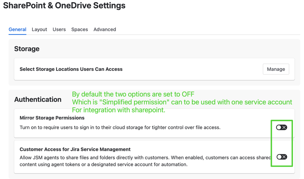

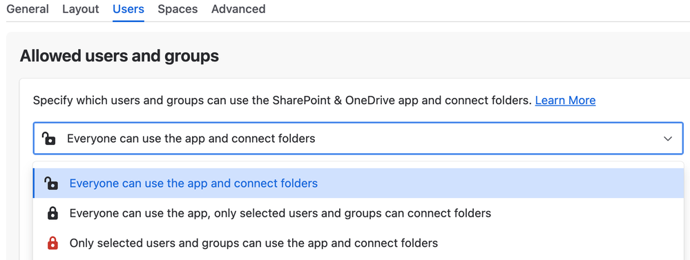

May 22, 2026
@Charlene Freeman just adding to my previous suggestion in the above thread, you can use the simplified permission where, only a service account is needed to setup the folder to be used in a jira space. More controlled permission can be implemented using Jira's group. I am adding two respective screenshot from the app configuration.
-Bibek
