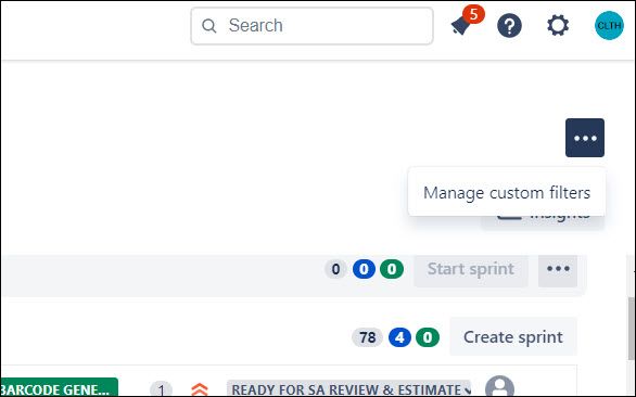

Claire Theuma
November 14, 2022
Hi Nico, thankyou for responding. I checked your suggestion but the only options I have beneath the three dots option is manage custom filters so this will not work for me - readings Trudy's reply above and checking what JIRA I am using it is a Team Managed Project.
I have found a workaround (but this was some effort for me to implement) by inserting the JIRA default estimate attribute into the Requirement, bug, task JIRA card template and working through all the existing JIRA cards created and moving the existing value inserted into the estimate attribute I had created into the default estimate attribute - this has worked but it took me some time. Next time when I am setting up the card templates I will ensure I use the default estimate attribute ;-)
