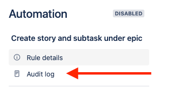

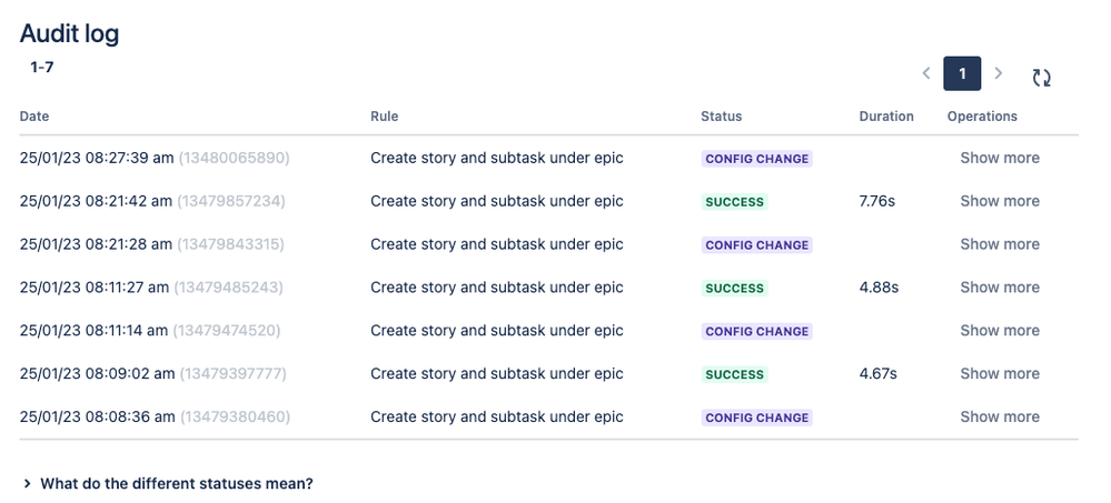

The Audit Log for a rule can be found when you are viewing the rule.
When you click on that you will get a list of each time you changed the rule (Config Change) and each time the rule executed with a status (i.e. Success, Some Errors). You can click on the Show More link on the right to get more information about the specific event.

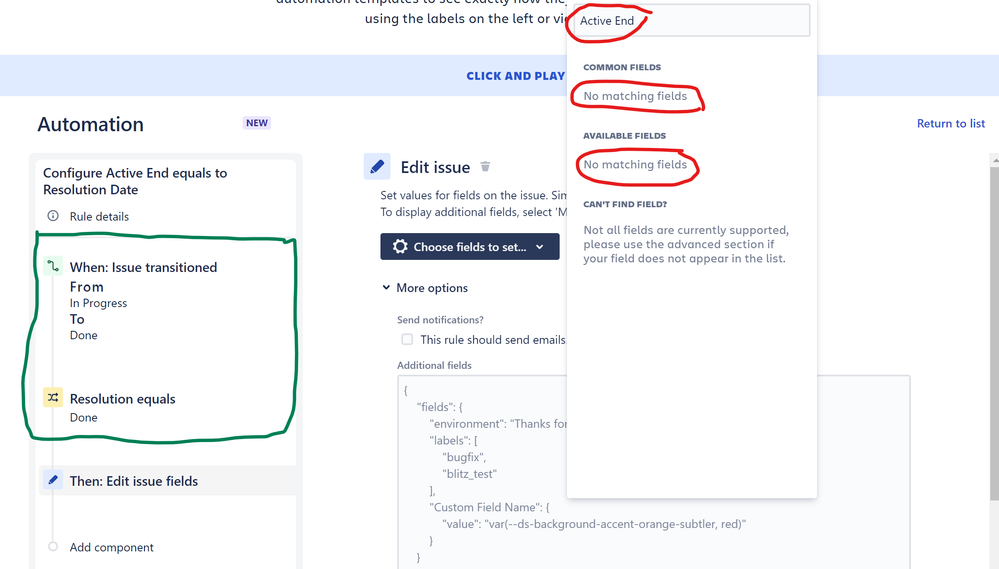

Sucharitha Revanuru
January 25, 2023
See the Screenshot above:
Rule: Green Highlighted - When the status of an issues transitioned from In Progress to Done and condition being the Resolution of the issue is done, then the Active End date should be defaulted to Resolved date.

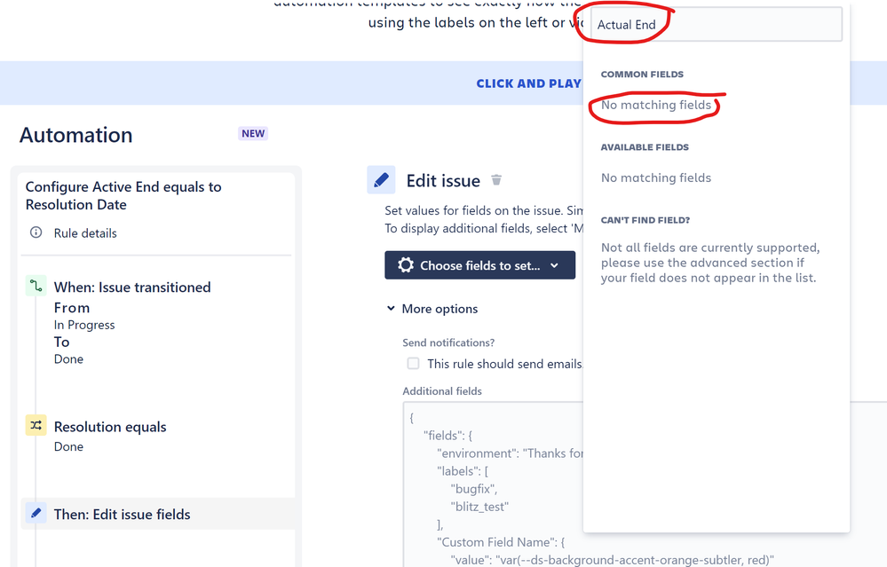

But here I'm stuck at Edit Issue fields option where Actual End is not found in the drop down (see red highlighted), as it seems not supported at this time.
Please help me at Edit Issue fields if you can!
Thanks

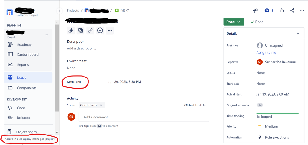

Please show us a screen image of an issue that uses the "Active End" field, showing that field on the screen.
What type of field is "Active End"? Is it a Date Picker field?
Is this field used in a Company Managed project or a Team Managed project? When viewing the project you will see which type it is at the bottom of the navigation pane on the left. Example.

Sorry Typo error - it is "Actual End" (Actual end date field) - Red Highlighted in the screenshot below.
Just to give you some context I have two custom fields in my project - Actual Start and Actual End date fields. Over here I'm looking for getting the Resolution Date field value in to Actual End date field value. And in edit issue dropdown the custom field "Actual End" isn't there.
And it is a Company Managed Project.
Sucharitha Revanuru
January 26, 2023

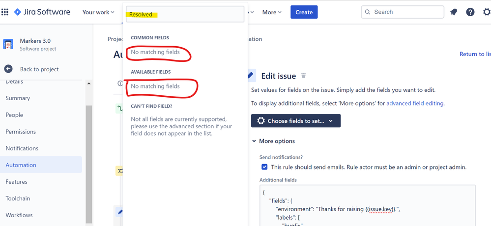

In the image above, a search for Actual End field returns no matches.
Trudy P Claspill
January 26, 2023
Based on your screen image it appears that you are trying to construct this rule on the Atlassian site for the Automation Playground.
https://www.atlassian.com/software/jira/automation-template-library
The only fields available there are the ones that Atlassian has made available in the Playground. That is not constructing a rule on your own Atlassian Jira site with access to your projects and fields.
You need to be creating the rule on your own Jira site.
In the project where you want this rule navigate to Project Settings > Automation. Then click Create Rule. That will allow you to construct a rule within your site, with access to the fields you have defined for your site.

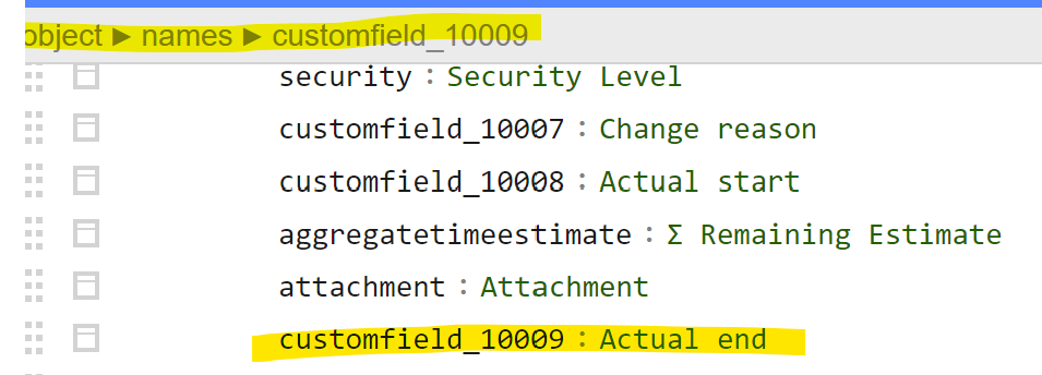

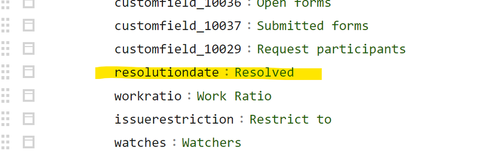

Now, I'm on my project Site, found the Custom field - Actual End. But ResolutionDate (Resolved) isn't there in the Drop Down. See the JSON Referencing for the ResolutionDate field (which is Resolved). See the JSON below.JSON Referencing for Resilutiondate field .png
Also see the screenshot below where Resolved (ResolutionDate) isn't there in the drop down. Resolved Date_No match.png
For your information see below the JSON referencing for Actual End
How can I copy the ResolutionDate (Resolved) field value into Actual End field? or is it something that because we don't see Resolved date field in JIRA, we can't find it in the Choose fields drop down? Am I missing something here?

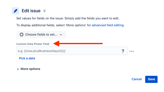

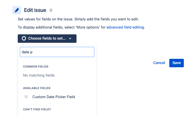

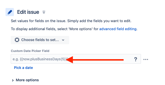

First, in the Edit Issue action you need to choose the field you want to set. In that case you need to specify your Actual End field. In my example I have chosen the my field named "Custom Date Picker".

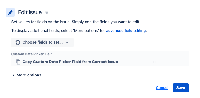

After check-marking the field, click somewhere outside of the Available Fields list to make that pop-up go away. You will then see the field you selected on the screen, like below.Screen Shot 2023-01-27 at 11.05.56 AM.png
Next, you fill in the entry field below that to specify what value to insert into the field you picked.

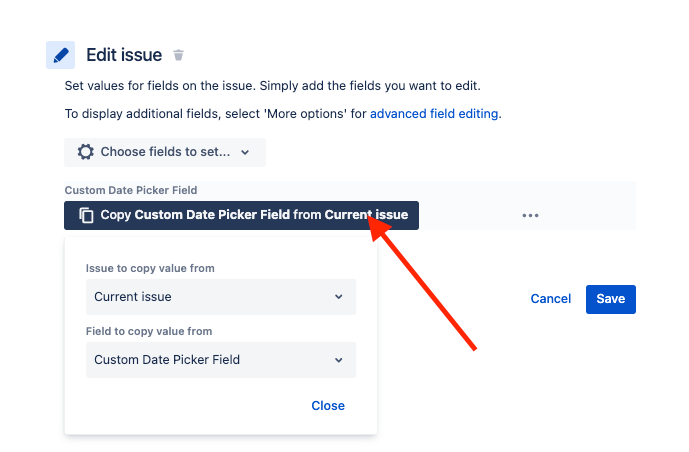

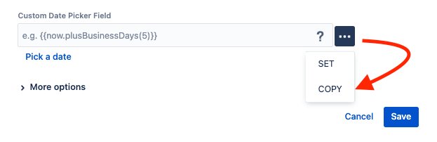

You can choose the type in a smart value to get the value from another field. Or you can click on the ... button to the right and select COPY to use the built in functionality for copying data from one field to another.
When you select that, Jira will automatically fill in copy instructions.

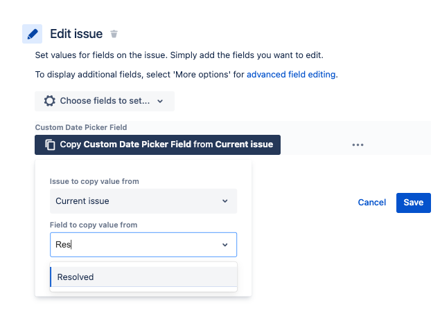

You can click in the X text in that field to pop up a dialog to let you change those instructions.
Here you can change which field you are copying data from, and the Resolved field is one you can choose.

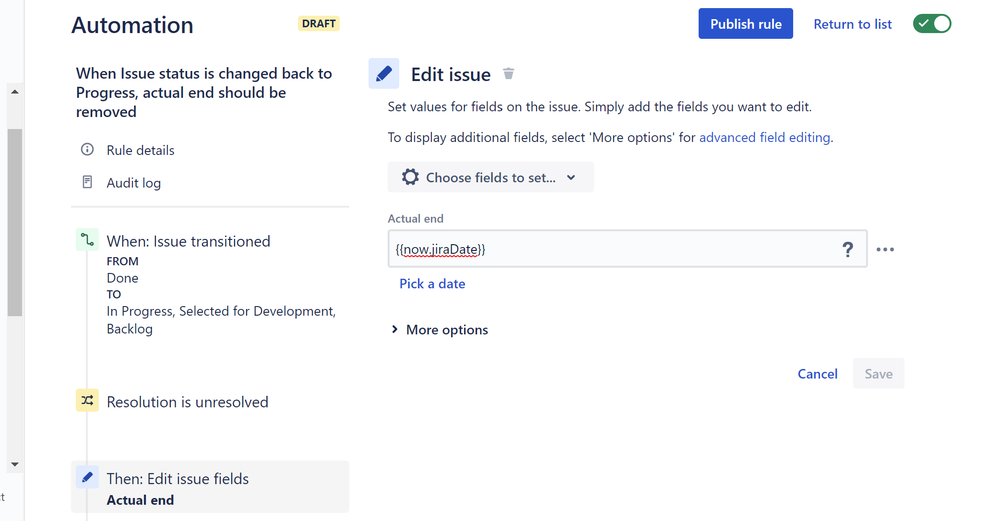

Sucharitha Revanuru
January 30, 2023
Sorry just another question:
> If I wanted to change the issue status back to IN Progress, how can I remove the Actual end date (means I would want to cancel the rule above)?
For which I wrote another rule (see below), but it seems to be not working. Actual end to None.png
Trudy P Claspill
January 30, 2023
Hello @Sucharitha Revanuru
If you want the field to be blank then you need to not put any value in the field where you have specified {{now.jiraDate}}.
