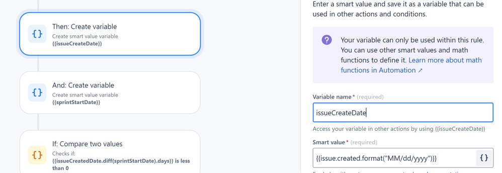

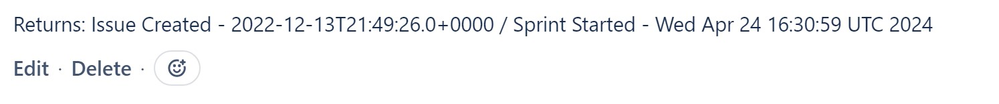

I'm trying to create an automation to add a label in a card added after a sprint starts. In my organization, we have to label the new cards added after the sprint started as "added points". To avoid doing this manually - most of the times people forget to add the label - I created an automation to compare the issue created date with the sprint start date. I tried to use smart values to save each of dates in the same format, and I used {{issue.created.format("dd/MM/yyyy")}} and {{issue.Sprint.startDate.format("dd/MM/yyyy")}} to assign the format dates to the two smart values created. When I run the automation, I'm getting an error, so I added a last step to write the two dates (issue.created and issue.Sprint.startDate) in the comment section.  When it ran again I got something like this:
- issue.created = 2024/07/09 12:30:22.22 pm"
- issue.Sprint.startDate = Wed, Jun 20, 2024 1:30:05 pm"
I guess the format is not working due to the different format the dates are set in the issue and the sprint. Is there a way to compare these dates? Thank you. I appreciate your help.

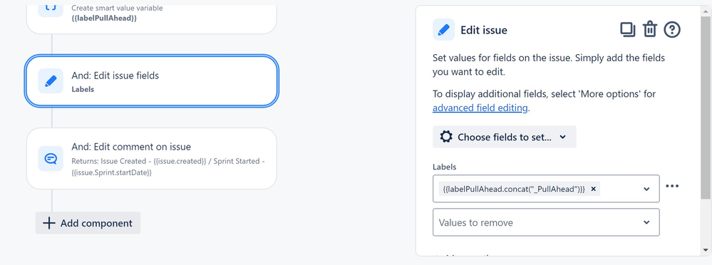

When asking for help with an Automation Rule, it is vital that you share with us screen images showing the complete rule and the details of each step. Obscure confidential information. It is also helpful if you share with us the details in the Audit Log generated when the rule ran.
Bruno Leite Cervantes
July 10, 2024
Thanks for the advice @Trudy Claspill . Here are the screenshots. The last screenshot is the date written in the comment field after the automation ran.
Trudy Claspill
July 10, 2024
Why are you creating variables and then using the variables in your comparison? You can simply use the smart values you used to create the variables.
{{issue.created.diff(issue.Sprint.startDate).days}}
When you create Variables the values are stored as text. The "diff" function can be used only with smart values that are Date or Date/Time types.
I think if you use the Log action to print out the smart value you were using with the Variables you will find you are not getting the answer you expect. But if you simply use the original issue smart values then you will get closer.
