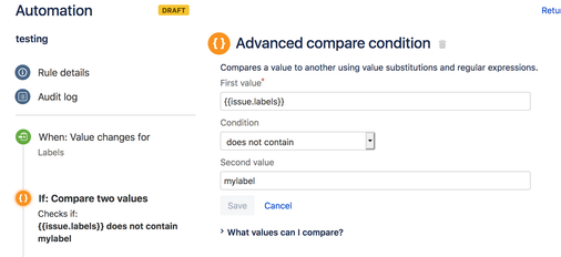

I want to trigger an action when label 'mylabel' has been added or removed.
It should not trigger when a label containing 'mylabel' has been added or removed, for instance 'mylabel1' or '111mylabel-2'.
How can it be done?
Petter Gonçalves
July 19, 2019
Hello Simon,
JIRA Post functions only triggers upon issue transitions. That been said, you will need a plugin to trigger any action when an issue is edited - More specifically when a new label is created.
You can use Automation for JIRA App to configure a rule that will trigger upon a new label creation, adding the condition that this label must not contain "mylabel":
Let me know if this information helps.

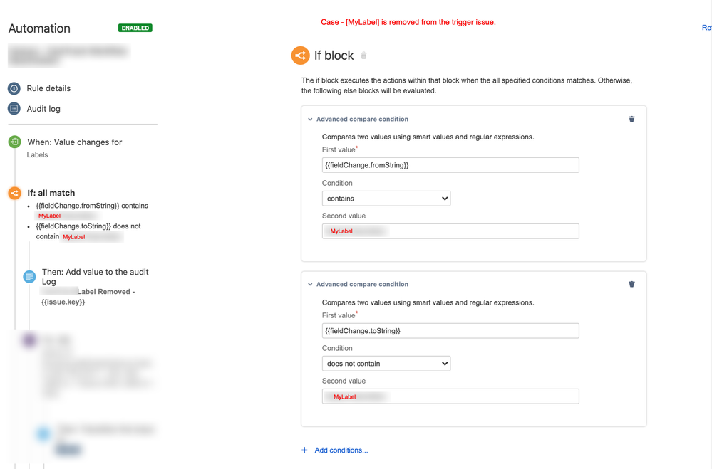

@Petter Gonçalves I know this is a year old, but I have a similar requirement.
From what I can tell, your solution doesn't tell us that the ticket previously had a label of "mylabel" and now it doesn't; all it tells us is that at the time the rule is triggered, there is no label of "mylabel" - the ticket may never have had that label. Is that correct?
My requirement is to trigger a rule when a specific label is removed from a ticket, as we have Plans (advanced roadmaps) set up pulling from a label and if someone accidentally (or not) removes the label then the issue disappears from the plan. I've looked at smart values, and see that there is a fieldChange.fromString and fieldChange.toString, but I'm not sure I can use those in this kind of rule. Can you help me out?
Like Masudur Rahman likes this
Masudur Rahman
September 16, 2020
I had the same requirement and did the following tedious way. This might be helpful if you still need to fulfil your requirements.
Thanks
Masud
