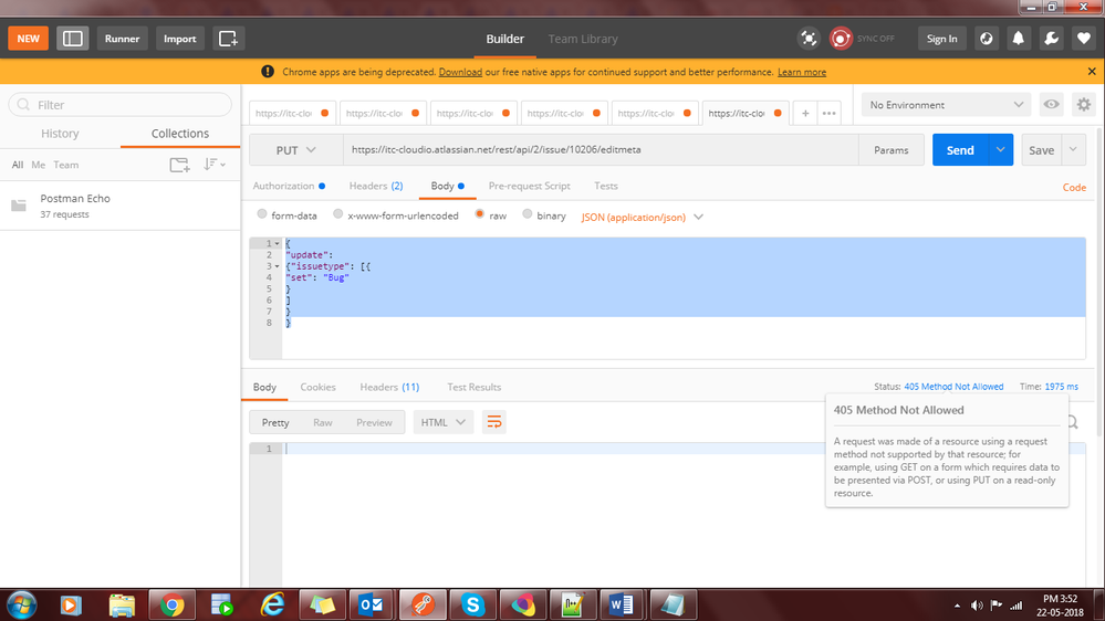

I have requested below rest api and  below payload:
rest/api/2/issue/10206/editmeta
My Requested payload is:
"update":
{"issuetype": [{
"set": "Bug"
getting 405 method error please find my attached screen .If in case if i am wrong please help me on this.
Alexey Matveev
May 22, 2018
Here is it. First I executed GET rest/api/2/issue/issuekey/editmeta. The result was like this:
"issuetype": {
"required": true,
"schema": {
"type": "issuetype",
"system": "issuetype"
"name": "Issue Type",
"operations": [],
"allowedValues": [
"self": "http://localhost:8080/jira/rest/api/2/issuetype/10100",
"id": "10100",
"description": "A task that needs to be done.",
"iconUrl": "http://localhost:8080/jira/secure/viewavatar?size=xsmall&avatarId=10318&avatarType=issuetype",
"name": "Task",
"subtask": false,
"avatarId": 10318
"self": "http://localhost:8080/jira/rest/api/2/issuetype/10001",
"id": "10001",
"description": "Created by JIRA Software - do not edit or delete. Issue type for a user story.",
"iconUrl": "http://localhost:8080/jira/images/icons/issuetypes/story.svg",
"name": "Story",
"subtask": false
Look at the allowedValues. It means that issuetype can be set either to Story or to Task. Then I executed PUT  /rest/api/2/issue/issuekey with the following JSON:
{"fields":{"issuetype":{"id":"10001"}}}
The issue type field was changed to Story.
