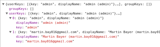

I didn't find documentation so I think it is internal REST service which is not documented and can be changed between versions. I tested it a little and following valid JSON works:
{"id":1,"boardAdmins":{"userKeys":["admin"],"groupKeys":[]}}
  • "id" is ID of board
  • "admin" is key of the user who is going to be set as administrator
you can set multiple users and groups as board's administrators

Does anyone know why this works for some users, but for other users this PUT method returns the message "\"myUsername\" is not a valid user."?
Note the additional backslashes + double quotes in front of and at the end of myUsername. I didn't add them, maybe they cause this problem?
I also noted that you talk about "user keys" instead of "username". Is there any difference? My scipt uses the username and for 99% of users it works just fine.
