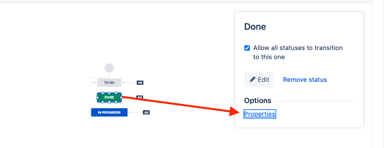

  1. Open the Workflow that affects the project/issues.
  2. Select the Status where you want issues to become read-only. This will show a pop-up that will include the Properties link.

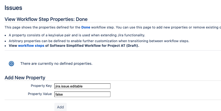

  3. Select the Properties link.
  4. Add the property jira.issue.editable and set the value to false.
  5. Click the Add button.
  6. Save the workflow.
For all issues to which this workflow applies, the issues in the specified Status will now be read-only. Note that this does not prevent changing the issue from the Status to another Status, and it does not block entering Comments on the issue. It prevents changing fields, like Summary, Description, Components, and so on. This will take effect immediately on all issues in that Status that are subject to the workflow. You may have to modify multiple workflows, if you have different workflows for different types of issues, or different workflows for different Projects.
