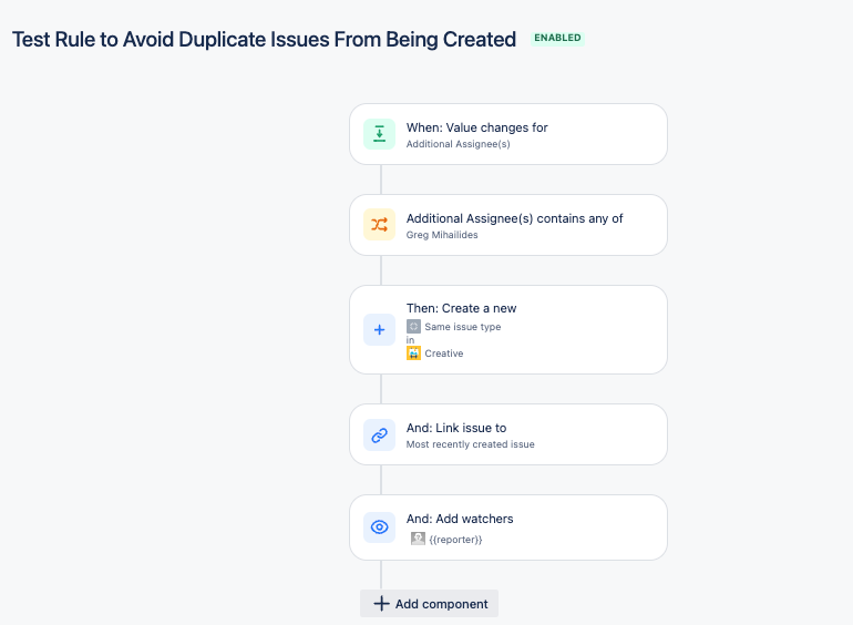

Hello all,
I'm looking for help with an issue that we've come across after setting up a few different related automations. Below is an example of an automation we have set up where when we add a particular user into the 'additional assignee' field, it triggers an automation to create an issue in that team's separate project and pulls in certain information from the trigger issue. This has been working well so far, until we created a similar rule for a different team (with a different project). The logic is the same but the person for the additional assignee field is different and the target location of that new issue with selected information is a different project. All new issues are being created, however, if we add the two separate assignees to that field at different times then the first person we added will get a second/duplicate issue created in their project since the automation triggers by changes to the field.
I am looking for an addition/edit to the logic that could search for duplicates and not create the issue if it has already been created. Some of the other examples I've found searching in the community aren't quite what I'm looking for and despite trying different aspects of the 'related conditions' 'IF' option, I haven't been successful.
Does anyone have suggestions for updating the logic to search for duplicates and block the issue creation from happening when it ID's one already created? Thanks!

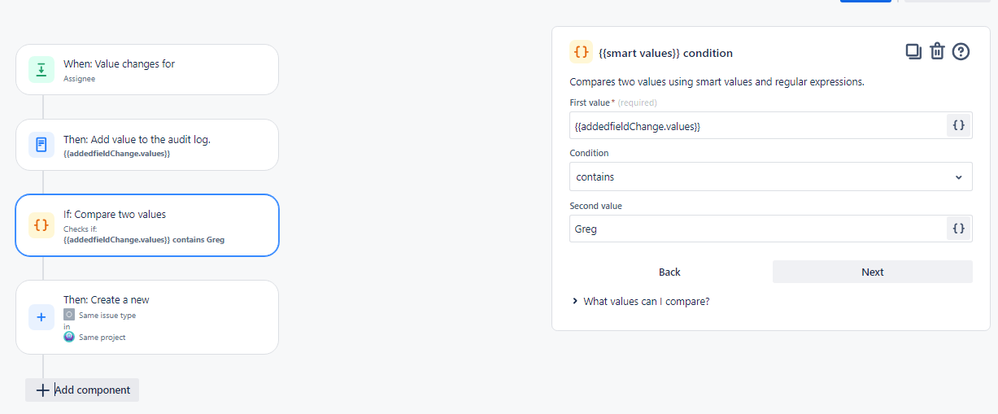

Hello @Greg Mihailides
I am not entirely sure what is the problem statement. Are you saying that you want to create new issues only the first time "Greg" is added to Additional Assignee and not every time rule is getting triggered?
If so, I think you could just check if {{addedfieldChange.values}} is equal to Greg and only then create the new issue. Some thing like below screenshot.
If this is not the problem statement, please clarify..

Greg Mihailides
March 14, 2024
Thanks, @Kalyan Sattaluri this worked well. Appreciate you taking the time to help out!
