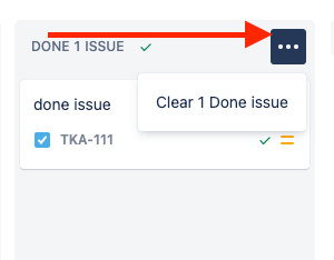

3. You could use the Clear Done option that is available in the Done column.

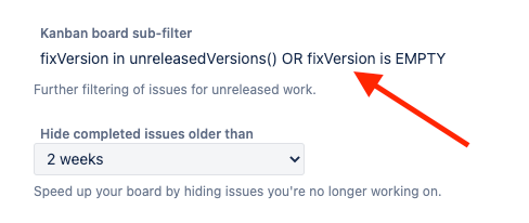

1. If you implement Kris's suggestion #2 to change the base filter of the board to exclude the Done issues, then the issues will also be excluded from the built-in reports for that board. Instead I would recommend that you change the Subfilter for the board so that the issues would be hidden from the board but included in reports.

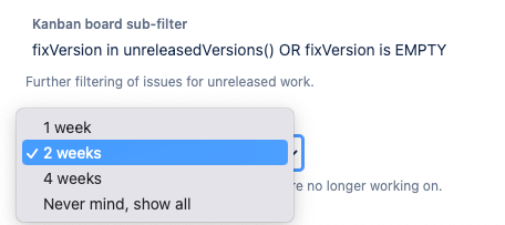

2. Also for this type of board you can configure the "Hide completed issues older than" option shown in the above image. The shortest time period available is 1 week. This will automatically hide the issues from view when they have been done the specified period of time or longer.
