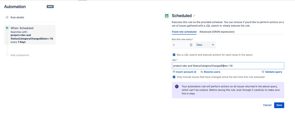

There is nothing native in JIRA Cloud that you can access that will tell you when a card was moved to a column/status. You can access the StatusCategoryChangedDate field via JQL queries to find out when an issue last changed Status Category.
(All Status values are assigned to a Status Category - To Do, In Progress, or Done. But you may have multiple statuses that belong to the In Progress category, and each of these might display in a different column in your board.)
If it is not a requirement to post the information to Slack, you can simply create a Saved Filter and then subscribe to the filter to get it sent to you periodically via email.
Otherwise, you can set up a scheduled task like this to check the StatusCategoryChangedDate:
This page says how to incorporate sending a message to Slack in a JIRA automation rule:
https://support.atlassian.com/jira-core-cloud/docs/use-automation-with-slack/
If you must have the notification based on the Status, rather than the Status Category, being unchanged, you may have to look at a third party app from the Marketplace.
