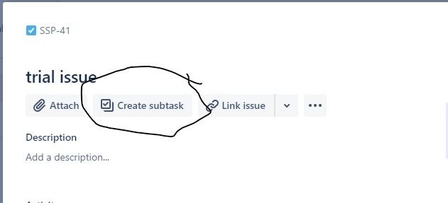

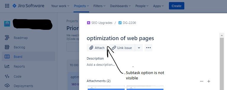

How can I add subtask from Issue iteslf .It is not visible with Issue
bhoopesh dubey
May 30, 2021

Check if the option is in the "other things you can do" menu - the ... to the right of the options.
Matthias Mette
May 31, 2021
Hi @bhoopesh dubey
you need to enable the subtasks and add the subtask issue type to the project´s issue type scheme.
You can check the issue type scheme if you follow these steps:
  1. Go to the desired project
  2. "Project settings"
  3. "Issue types"
  4. "Edit issue types" (top right corner)
  5. Drag and drop the "sub-task" issue type to your current scheme
  6. "Save"
