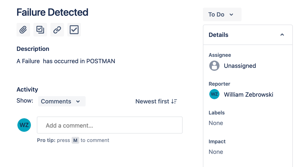

No matter where I put the assignee parameter in the body of the request, it does not populate in the Issue that I'm creating in JIRA. I'm a bit new working with JIRA's REST API so my ticket request is pretty simple (not much custom fields at all -but Im working slowly getting there).
However, I believe the format/syntax is right because I'm not getting an error parsing JSON message error in the response. And the ticket is still being created in JIRA even when I have 'assignee' in the body of the request. Having the 'assignee would be a neat feature to have automatically generated through the request for notifications Service purposes.
Can't I place 'assignee' param go anywhere on this request? I've tried in a few spots with no luck.

Which creates this ticket (Screen Shot):

@Ghulam Murtazaif you are using Jira Cloud, you can put the accountId in quotes, like the example bellow.
  "assignee": {
      "id": "21435654322fdgvsdfsd"
 Remembering that the assignee must have a license and permission to be assigned to the project.
I hope I helped you.
