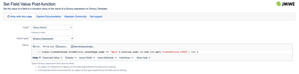

Hi @Anita Hütter ,
Using JMWE, to set the Story Points field value of an issuetype(say "abc") to sum of the Story Points field value of all the tickets which belong to the Epics linked to the "abc" issue :
  • Add a “Set field value (JMWE app)” post-function on the desired transition of the "abc" issuetype
  • Select “Story Points” field
  • Select “Value Type” as “Groovy Expression” and add the below Value :
issue.linkedIssues.findAll{it.issueType.name == "Epic"}.stories.sum{ it.sum {it.get("customfield_10006", 0)} }
Replace customfield_10006 with the id of "Story Points" field.
The above script finds the Epics linked to the current issue(through any link type) and sums the Story Points value of all tickets which belong to the Epics.
