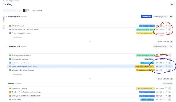

Yes, that is what I was suggesting...a project per milestone. I tested this in my sandbox projects, here are some samples...
I created a filter: project in (PMTEST, PMTEST2) ORDER BY created DESC
I then created a new Scrum board using the new filter and started a sprint. (Note the issues from the two projects)
I added an issue from Project PMTest2 to Sprint 1
Then I pulled them into the gantt chart using BigPicture. I could drill down on these, but it's too hard to see in a screen shot. Expanding these out will show me the time ordered grouping I think you are looking for (if I had more sprints, versions, etc. set up)

A minor comment: both of your screenshots look the same, so I couldn't see the extra PMTest2 issue you added to Sprint 1. But I believe you!
