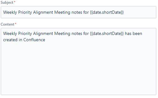

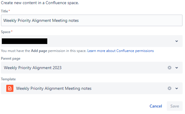

I'm currently making an automation to make a copy of a confluence page for a weekly priority alignment meeting. They want the title of the Confluence page to include the date of the meeting for each new page, and an email to notify the participants.
Date format mm/dd/yyyy
I've tried to use smart values, but they don't transfer to Confluence or to Gmail
Is there an alternative way to do this that I'm unaware of or a different language that will serve the purpose better?

You want to format the date in the page's title?
{{now.format("dd/MM/yyyy")}}
^ This should work
I do sometimes find the time converts to UTC though, so it depends on your timezone if it will have the correct date.
Instead I find setting the timezone works - eg.
{{now.convertToTimeZone("Pacific/Pago_Pago").format("dd/MM/yyyy")}}
You can see a full list of timezones options here: https://joda-time.sourceforge.net/timezones.html, as suggested on this help page

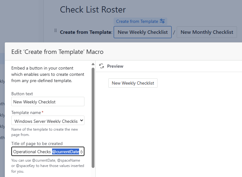

In the template itself I haven't found a way to put an automatic date in, but when you configure the button "Create from Template" (macro) you can make sure the page title has the date in it using @currentDate.
I believe it only does yyyy-MM-dd format but to me that makes most sense (sort alphabetically = sort chronologically).
