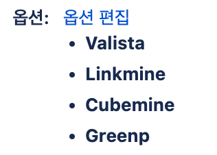

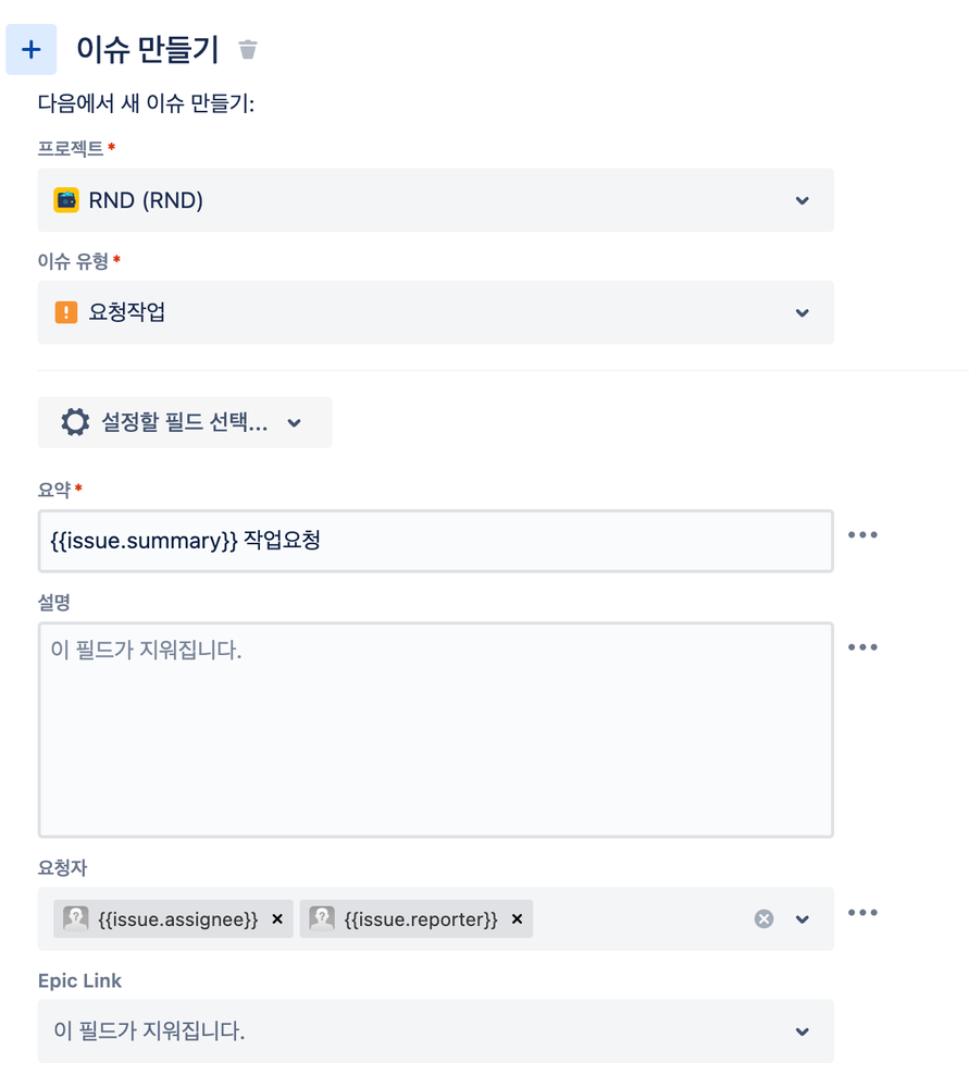

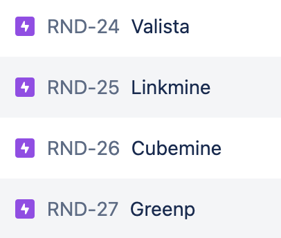

Project B's Epic
How Can I Match created new task's EpicLink and  Same name's Epic ??

1. maybe 4 ~ 10 epics.
2. Select List Field name is Platform. Epic Link is new Issues' epic.
3. Select List's item name equals Epic name.

Because a Select List is value based, and an Epic Link is Key based, I think it'd likely be easier to set this using IF/ELSE Conditions. It shouldn't be too bad if there's only 4-10 Epics to do this.
This would be a separate rule from the "Create Issue" rule - the rule would look something like...
  • Trigger: Issue Created
  • Condition 1: Issue Fields Condition
    • Field = Issue Type
    • Condition = equals
    • Value = Task
  • Condition 2: If/Else Block
    • IF...
      • Condition: Issue Fields Condition
        • Field = Platform
        • Value = Valista
      • Action: Edit Issue
        • Field = Epic Link
          • Value = RND-24
    • ELSE-IF...
        • Field = Platform
        • Value = Linkmine
        • Field = Epic Link
          • Value = RND-25
    • ...etc (create another ELSE-IF section for each Epic)
A few notes on this rule...
  • I've provided an example for Condition 1, but this Condition should uniquely identify the Tasks you need to add to the Epics
  • To add the "ELSE-IF" second layer, you need to press "Add else" in the left-hand menu of your rule
  • You'll need an "ELSE-IF" layer for every Platform/Epic combination
  • Because another Automation Rule will activate this rule, you need to allow this to happen through the Rule Details
    • Check the box for the field - Check to allow other rule actions to trigger this rule. Only enable this if you need this rule to execute in response to another rule
Let us know if this works for you!
