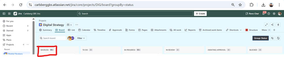

Hello,
I have a team-managed project and I want to hide the Backlog section on the board so that the board looks less complicated. How do I do this? Please help.
Attaching the view of my current board.

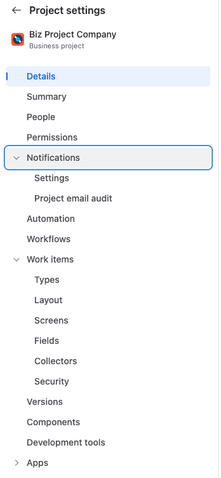

From Project Settings these are the available options. As you can see, there is not Board option.

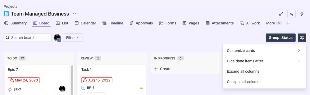

And these are the only options available from the board view itself.
The settings you are thinking of are available only for boards created with Software projects, or boards created from Saved Filters.

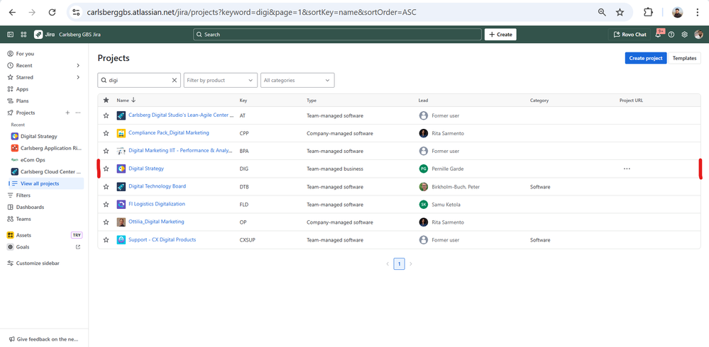

Also, what type of project does this concern? Get that information from the View All Projects page under the Projects menu.
HQRAZAHS
July 17, 2025
@Trudy P Claspill  its the team-managed project. The backlog often contains a large number of issues or tickets, many of which are not immediately actionable. Displaying all of them on the board can clutter the interface, making it harder for team members to focus on current priorities. By hiding the backlog, the board remains clean, simple, and easier to navigate—allowing the team to concentrate on the tasks that are actively being worked on during the sprint or current workflow phase.
HQRAZAHS
July 17, 2025

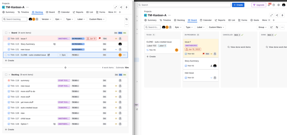

There is not an option for a "Backlog" screen to which you can relegate the backlog items so that they don't disrupt the focus of the board view. A Backlog screen option is available in the boards used with Software projects.
You cannot remove the Backlog column from the board in these projects. The column is directly tied to the Status it displays. Removing the column means deleting the status from the workflow. In that case the issues have to be assigned to another status, so that does not solve your problem.
With a Team Managed Business project your only options are to collaps the column as suggested by @Valerie Knapp or use a filter to hide the issues.
You could consider setting up a separate project specifically to hold your Backlog issues. Moving the issues to that other project would hide them from this board. Your team would need to review the backlog in that other project. As items near the point at which they could become actionable, you could move them back into this project. That would reduce the number of issues shown in the Backlog of this project.
You could consider create a Software project, and moving all the issues to that project. With a Software project you can elect to use a Kanban board and enable a Backlog screen. The "backlog" issues are then displayed on the Backlog screen, reducing the number of issues visible on the board.
With a Team Managed Software project Kanban board you would still have a column for every status. Visibility of an issue in the columns of the Boards is determined by its presence in the Board list vs. the Backlog list on the Backlog screen.

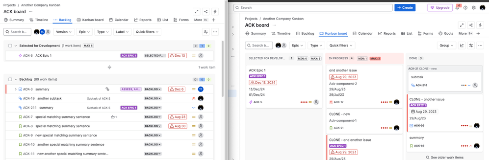

With a Company Managed Software project Kanban board the visibility of an issue on the board is based on its Status. You decide which Statuses mean an issue is "in the backlog". Columns for those statuses are not shown on the board. To show an issue on the board you changes its status.

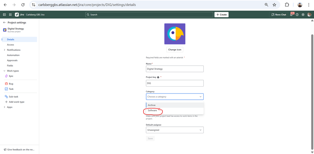

@Trudy P Claspill I have the capability of changing the project category to 'Software'. Is it the same option you are referred in your last comment "You could consider create a Software project, and moving all the issues to that project. With a Software project you can elect to use a Kanban board and enable a Backlog screen. The "backlog" issues are then displayed on the Backlog screen, reducing the number of issues visible on the board.".
If so, and after I change the category to 'Software'
1. Can you confirm if this will not impact any other sections?
2. can you guide me with the next steps (which you explained above) so that I can have the capability to remove the 'Backlog' field from Kanban board without actually removing this field from the entire workflow.project type change option.png

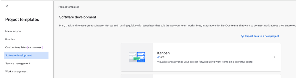

No, that is not what I was referencing. The project Category and the project Type are not the same thing. Changing the Category to Software will not change the underlying architecture of the project.
You would need to create an entirely new and separate Project using the Software Development > Kanban template.
To make an item visible on the board, in the Backlog screen you drag the item from the Backlog section of the list up to the Board section of the list. To remove an item from the board view you reverse that.
