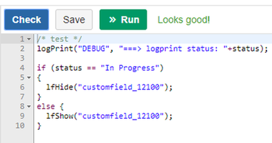

Thank you Alexey. I installed the plugin on a test environment. I have one Live Field and two post-functions.
Neither of them hide or show the field I specify.
The live field does exactly what your code does above but I changed the value to match my custom field.
The two post-functions are set up, one on one transition to "hide", and the other on another transition to "show". My guess is there's no need for the two post-function sil scripts if I do it in a livefield, but I'm trying whatever I can.
So I'm trying to use logPrint() to try to debug my "livefield" config. Nothing appears in the jira log. So I added the package to the logging. Still no debug and field never hides.

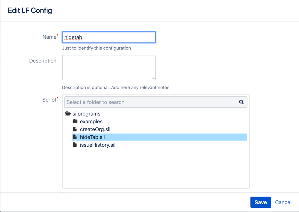

You do not have to create post functions. You need to create this script and attach this script to the live field.

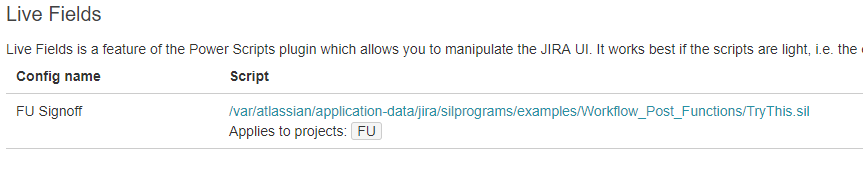

I already have that:
myLF.PNGStill nothing in the logs.

You should logPrint with ERROR. Or you need to set the DEBUG logging level for SIL in your Jira instance. You can find how to do it here:
https://confluence.cprime.io/display/SIL/logPrint
Darin Hafer
January 4, 2019
Yes, I already had that in place.
