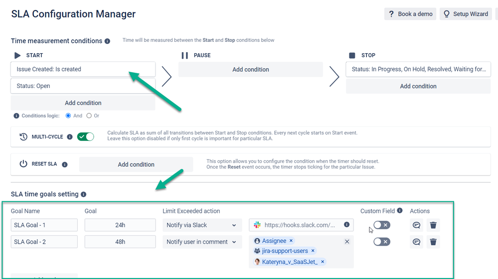

Hi @MahanthPrudhvi
It would be possible with the built-in SLA, such as in JSM, but for Jira Software, you can use only third-party add-ons. So if you are ok with apps, I suggest you try the SLA Time and Report add-on that was developed by my team.
You can configure SLA Start/Pause/Stop conditions and SLA goals as triggers for automation actions.
Use the 30-day trial period and just check this alternative solution.
MahanthPrudhvi
August 4, 2023
Hi @Kateryna_v_SaaSJet_ ,
Thanks for your suggestion. As I am not able to find any other solution that fits my requirement I am planning to  use your addon. I will start a trial version and if it fits good then I will go ahead with your addon.
