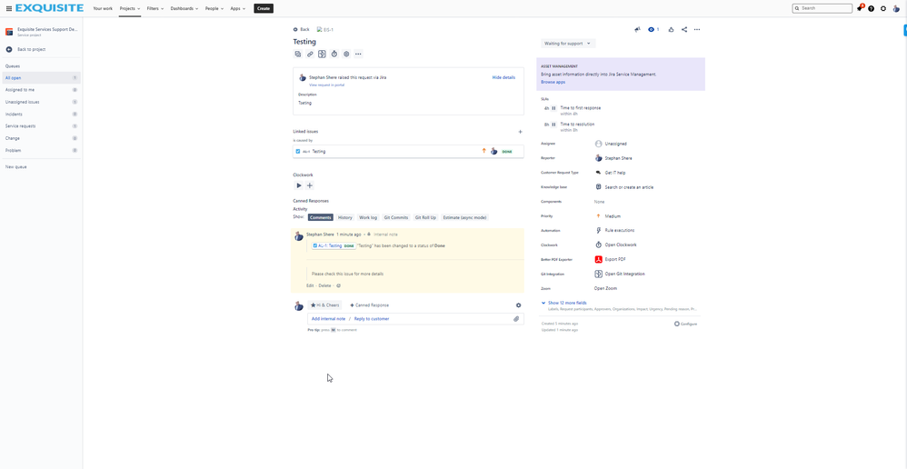

image.pngWe created a linked issue from Service Desk into Jira and when the Jira issue was transitioned to done it created a comment on the Service Desk project.
