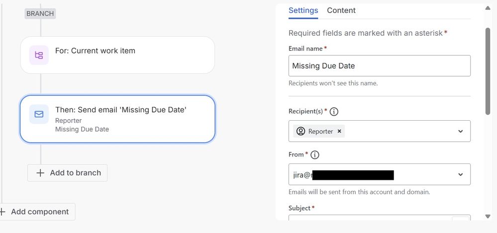

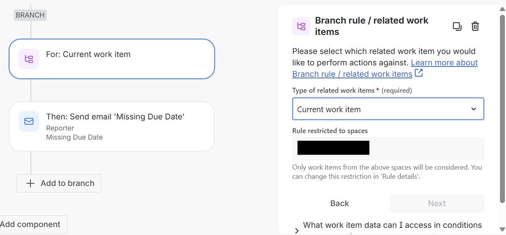

  2. FOR current work item : branch.jpg
  3. THEN : Send mail : sendmail1.jpg
But this doesn`t seem to work.

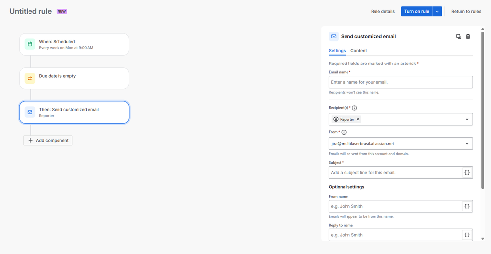

Hi @Mihai Vasile
There you don't need branch.
Try this one.
Trigger: Scheduled --> JQL - project = PROJECT AND duedate IS EMPTY
Action: Send e-mail
To: Reporter
Subject: ---
Body: --
Please let me know.

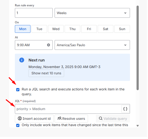

Hi, Mihai. Welcome to the Atlassian Community!
If you use the trigger like this:
You don't need to user "For current issue" or any other loop, because you already set that in the automation trigger. So would be something like this:
I started with a potential solution since it’s the most likely fix for your issue. That said, if you can share the automation logs and a bit more context about the “not sending email” part, that would help a lot.
