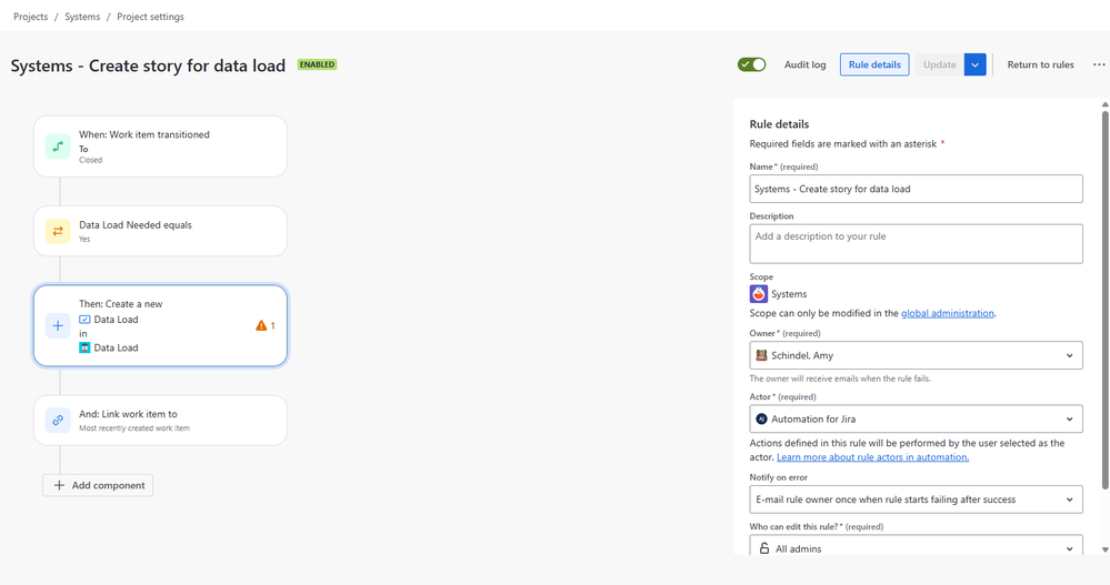

Automation overall screenshot:
Details of Create new work step:

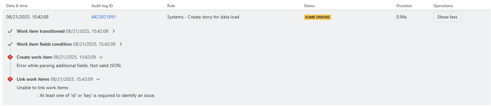

Audit Log:
If I take out the Json part in the additional fields, the automation works fine. That's why I think it's something with that particular part (in addition to the audit log telling me that it's not valid JSON.

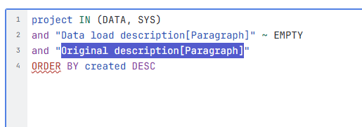

If I try to create a filter with the custom fields I made, here's what shows there for the smart values.
I've tried this with and without the [paragraph] part.  And I copied / pasted this directly into JSON and it still didn't work.  The rest api link didn't work for me today, but I can work with that more tomorrow to double check the the smart value / custom id of the custom fields.
