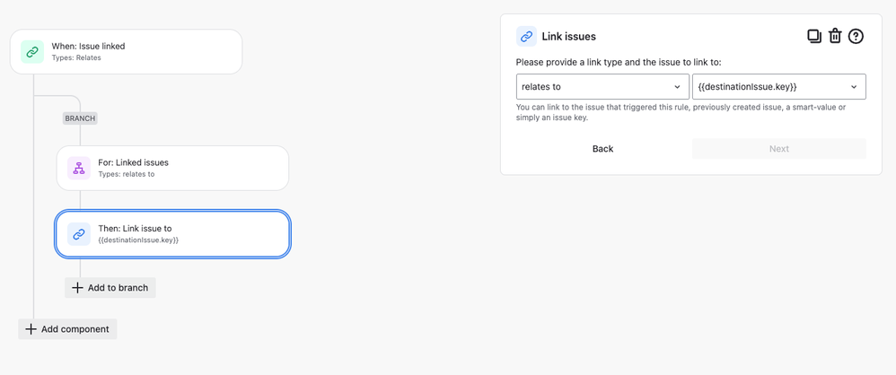

The basic structure would be:
TRIGGER: Issue Linked
In this trigger you can specify the type of link you care about. If you only care about a new issue link be created with the "relates to" link (versus, for example, the "depends on" link), then you can specify that in this trigger.
The Issue Linked trigger is unique in that it involves two issues. One issue is considered the trigger issue and the other is considered the "destination" issue.
If you linked are view ABC-1 and from there create a "relates to" link to ABC-2, then ABC-2 is considered the trigger issue and ABC-1 is considered the "destination" issue. For the next step we have to get all the issue linked to ABC-2 (the trigger issue) so we can link those to ABC-1. We'll use a branch so that we can then take action against each issue found.
FOR EACH: Branch rule/Related Issue
Select the Linked Issues option.
Select the "relates to" Link Type
The tells the rule to get all the issues that are linked to ABC-2 with the "relates to" link.
The next step is to link ABC-1 to all the issues you just found linked to ABC-2. You would do that with Link Issues action:
ACTION: Link Issues
"relates to" {{destinationIssue.key}}
The value in the curly braces is a Smart Value. It is a special smart value available because of the Issue Linked trigger. You'll have to type that in to the box that displays "Trigger issue".
