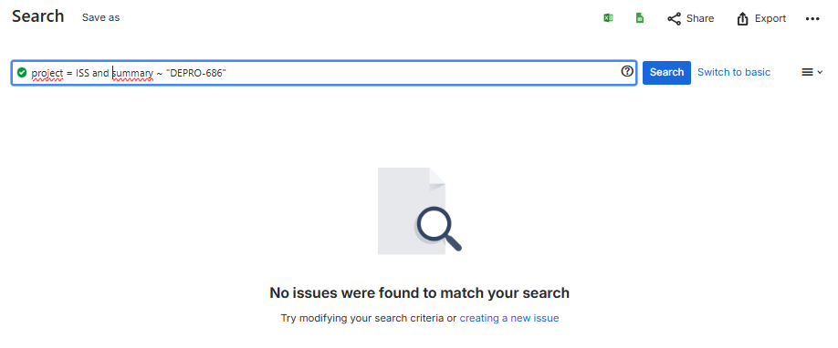

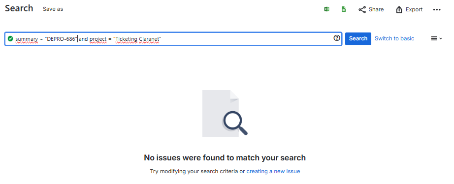

Hi,
I search a workitem that contains the key to another workitem in his summary field.
This JQL query does not return any results
However, I have a issuethat exists with "depro-686" in his summary.
Can you help me with my JQL query ?

Try project = iss and summary ~ "DEPRO-686*"

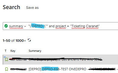

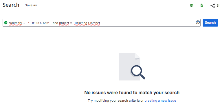

If you are searching for "DEPRO-686":
summary ~ "\"DEPRO-686\""
If you are searching for [DEPRO]:
summary ~ "\\[DEPRO\\]"

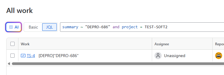

I replicated the same work item and jql and for me it works:
Try to debug the jql removing piece by piece
I found
a dash had slipped behind xxx-686-
If I remove the dash, it works.
