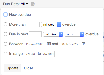

Tinker Fadoua
February 13, 2018
Click on "More" then type DueDate
You should get a screen like the one I sent you earlier.

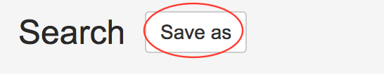

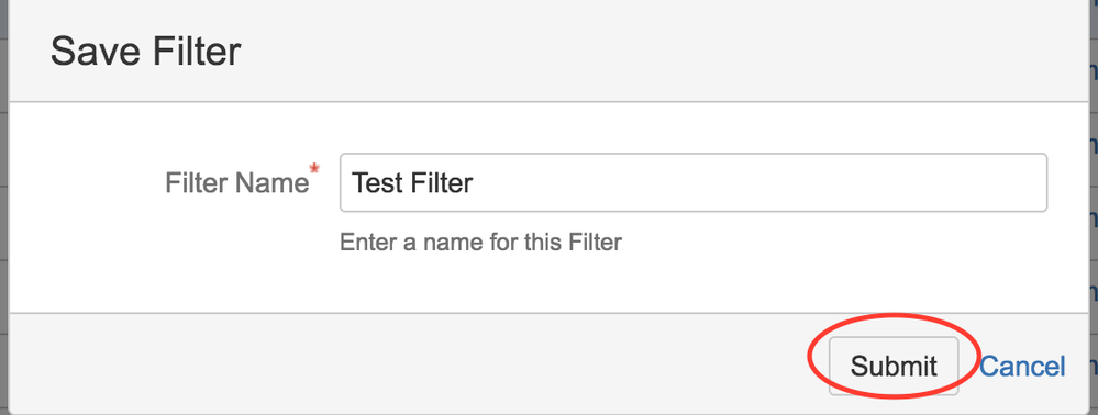

February 13, 2018
Great!
Now save your filter by clicking on what I circled in Red:
Then Click "Submit"

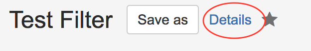

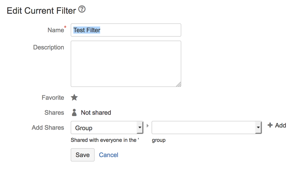

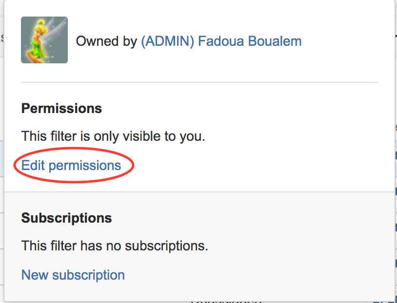

Tinker Fadoua
February 13, 2018
Sorry I couldn't add more screenshot
Once you click "Submit" on your next screen look at the top by your Filter's name then click on "Details" like the following screen:
Your screen should look like the following:
The Subsequent is what you should see:
Tinker Fadoua
February 13, 2018
Add shares is where you can decide who to share the filter with.

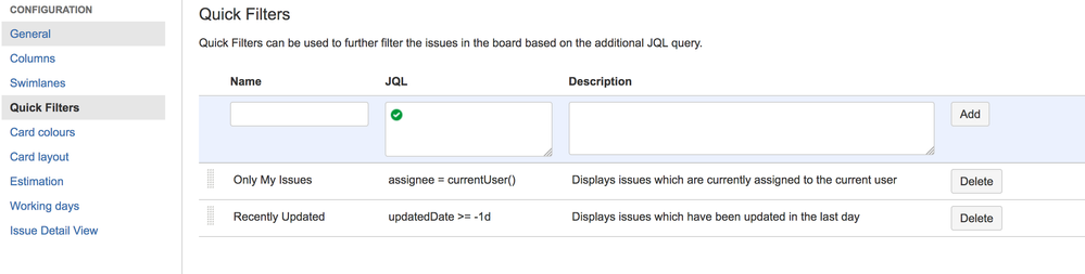

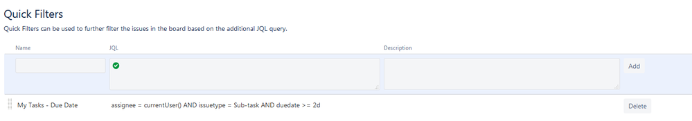

You can also add the quick filter to your backlog by "configuring the board". You can add the JQL query on the following screen:
Let me know how it goes or if you need additional assistance.

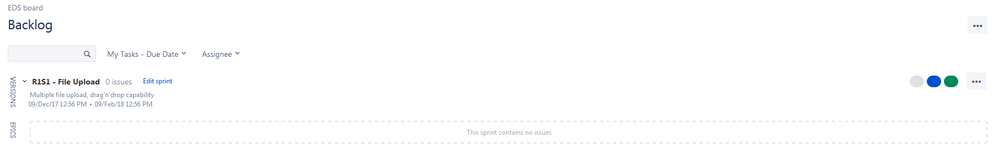

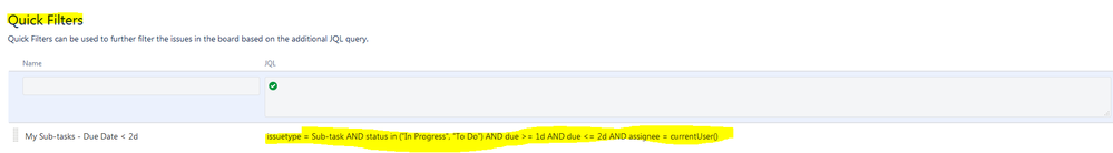

Raeeq Osman
February 14, 2018

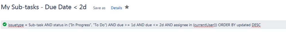

So I copied the query from here (it works when I use it here):
Picture 1:

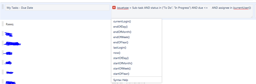

Then pasted it into a Quick Filter query:
Picture 2:

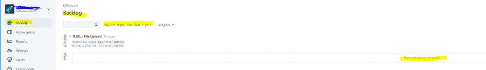

But when I go to the Backlog to select the Quick Filter, I don't see any results:

You mean when you click on "My Sub-tasks - Due Date < 2d" it doesn't display anything? Because you have to select it in order to see the issues on the backlog
Raeeq Osman
February 14, 2018
The last picture is the results after I already selected the filter.

This is a lot to ask but could you try copying this query and creating a Quick Filter for yourself? And also create some test stories with sub-tasks underneath and the due date as either 2/15 or 2/16?
Query:
issuetype = Sub-task AND status in ("In Progress", "To Do") AND due >= 1d AND due <= 2d AND assignee in (currentUser()) ORDER BY updated DESC

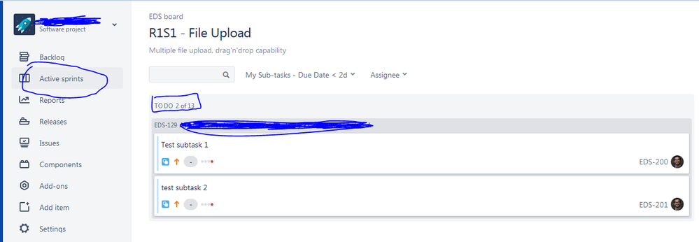

Raeeq Osman
February 16, 2018
So it appears that when I'm under the "Active Sprints" tab, the filter does appear to work and shows the two sub-tasks I created.
Picture 1:
However, when I'm in the "Backlog" tab and try using it, then the filter doesn't seem to work, which I guess isn't that big of a deal. Maybe there's some kind of system issue not allowing the filter to work in that tab.

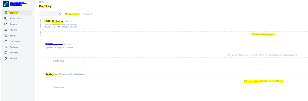

Picture 2:
I even tried creating a very basic filter to just show me all Sub-tasks (issuetype = Sub-task) in the Backlog and that didn't work either. So I think the problem might be just the Backlog being unable to show Sub-tasks because the filter worked when I changed it to show other issue types (Bug, User Story, Epic, Task).
Picture 3:
So really it's not that big of an issue. I can just let my team members know to use the filter in the Active Sprints tab, whenever we start a new sprint.
Tinker Fadoua
February 16, 2018
Actually Sub-tasks don't show on a backlog if that will help. JIRA doesn't work that way there is a turn around I can find it for you because i did it in the past but it wont show details about the sub-task
