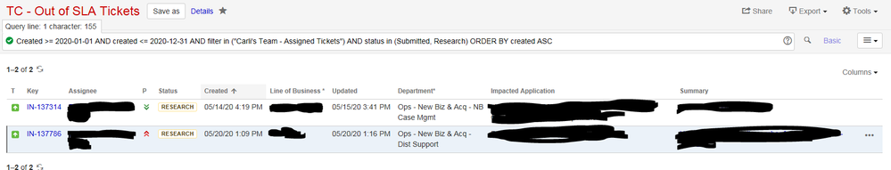

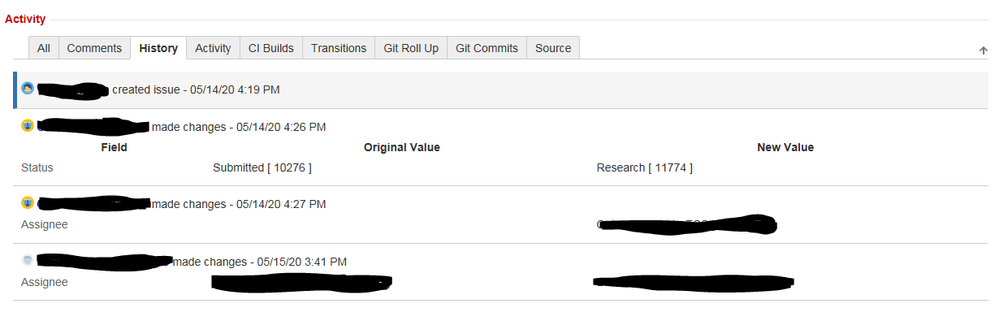

Thank you, Michael.  I tried that but I don't think they have ours set up so that we have those fields.   I've included snippets of how our tickets look, with the sensitive data blacked out.
Is there another way I can accomplish what I need?
Michael Andolfatto
May 24, 2020
Out of the box I don't believe it's an option unfortunately. You would need a plugin for automation such as ScriptRunner or Automation for Jira to log the dates as well as some light administration to create the fields and apply the logic.
There is also the Time in Status plugin though I'm not sure it comes with custom JQL options to pull the data you need.
