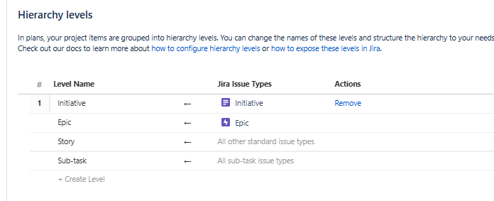

Hello @Angie Affolter ~ you didn't overwrite the Epic level with Initiative, did you?  If not, your hierarchy in Plans should show as Initiative > Epic > Story > Subtask.  Does your hierarchy config look like the screenshot below?

It does and yes when I look in Plans I do see the initiatives in the correct hierarchy.  I was looking in Boards
