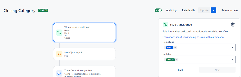

1. Trigger
Add Issue Transitioned trigger
2. Click on Add Action and search for Add If condition
if issue type equals Bug

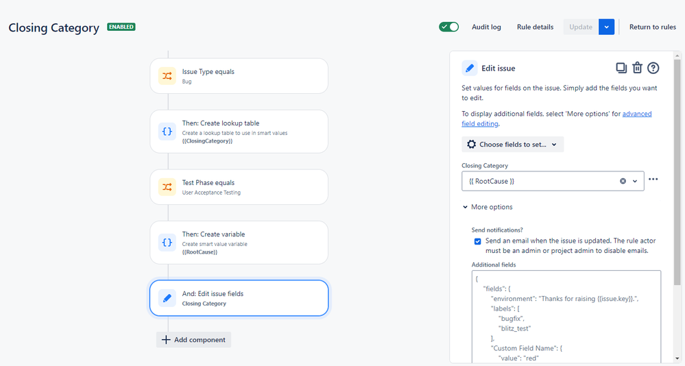

5. Click on Add Action and search for Create Variable
Name the variable say RootCause and in smart value put
{{ ClosingCategory.get(issue.Root Cause) }}
5. Click on Add Action and search for Edit issue
In Choose field select Closing Category
and in the text box below put {{ RootCause }}

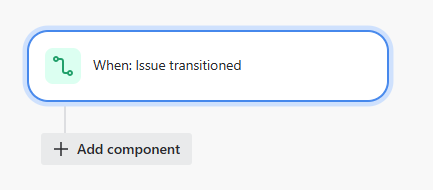

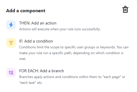

Assume you have added Trigger. This is how it would look
Click on + Add Component and on right side you will see a screen like this

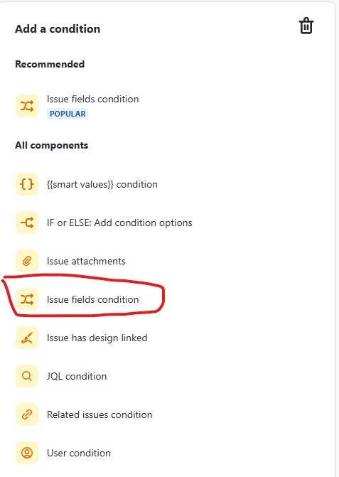

Click on IF: Add a condition
Then you will see a screen like this
select Issue fields condition highligted

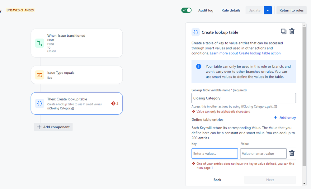

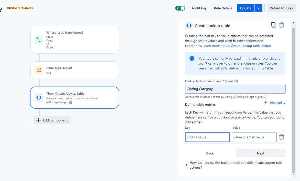

I think I've done step 2. And am now looking at step 3. But unsure what to do for the key and value table entries.
Variables need to be without spaces i.e. one word. So it should be ClosingCategory
in key enter enter Cutover and in value add Production Deployment / Cutover Issue
then click on + Add Entry to add remianing 5 values
Key | Value |
Cutover | Production Deployment / Cutover Issue |
Duplicate | Invalid |
Existing Production | Existing Production issue |
Invalid Defect | Invalid |
Non Reproducible | Cannot be tested, no clear recreation, speculative fix |
Requirements/Specification | Requirements change raised in pilot or rollout} |

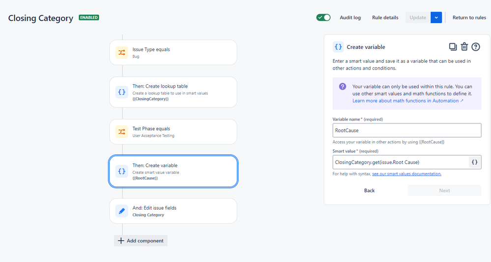

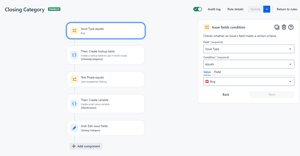

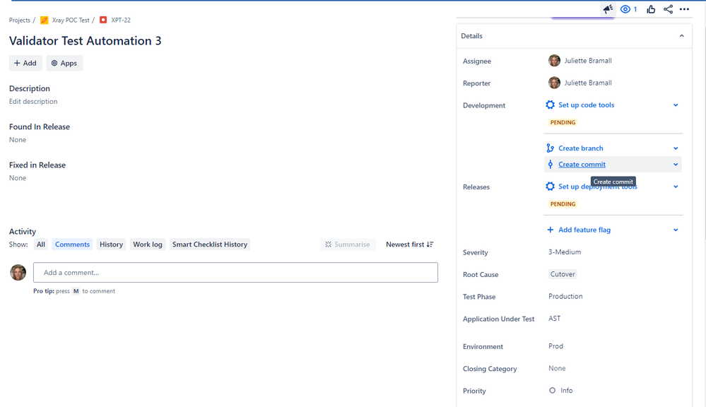

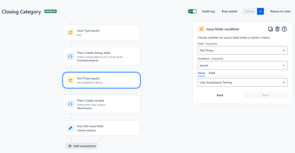

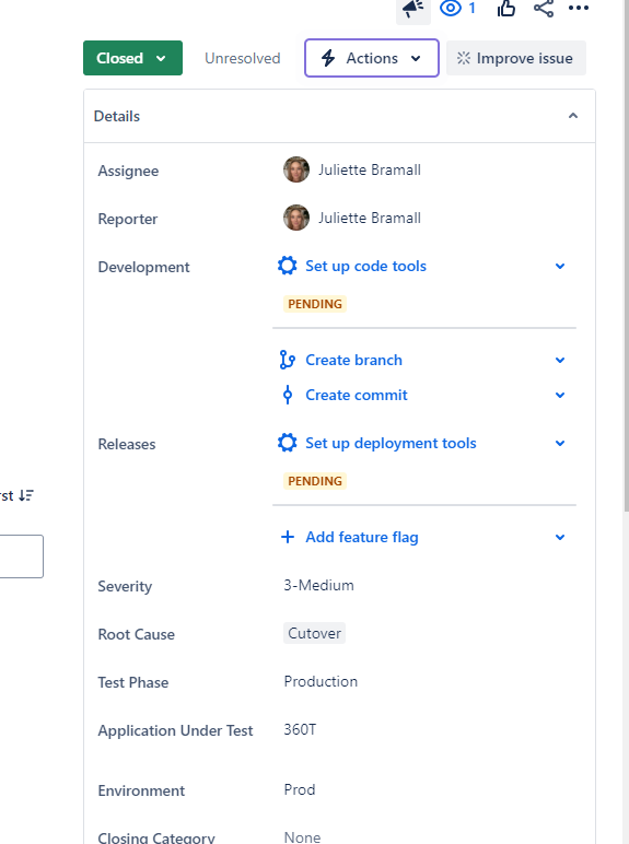

This is what I've set up. However, when I've tested it out by creating a bug with the relevant field options set as follows:
Root cause = cutover
Test phase = production
However the rule is not running according to the audit log and the Closing Category remains as 'none'.
Can you share the audit log to understand where the rule is not hitting? Audit log is right besides Rule Details

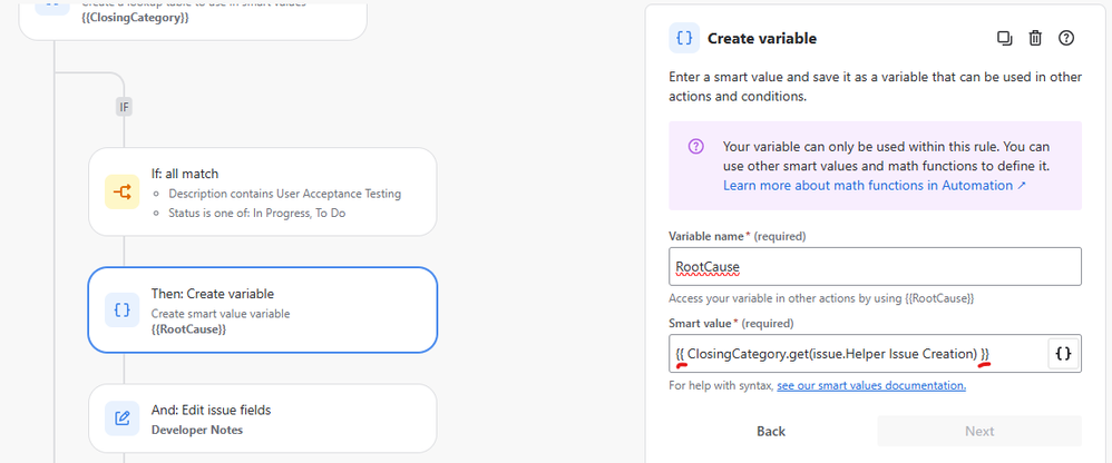

in the rule you have missed starting and ending curly braces

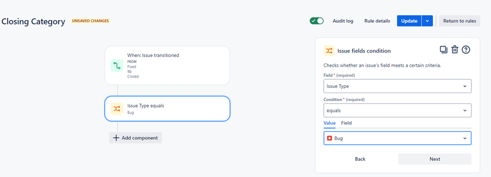

I've updated it as per attached. And re-tested the rule, but it's still not 'firing'?
can you share the trigger for your rule?

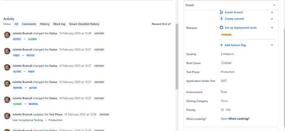

So you need to execute this transition on a bug that has Status Fixed to Closed. then only automation will get triggered.
The bug SS that you shared is already in Done status. So in this case the automation will not get triggered
I realised it wasn't triggering the rule as I've used the wrong transition. This is now corrected to be Retest to Closed.

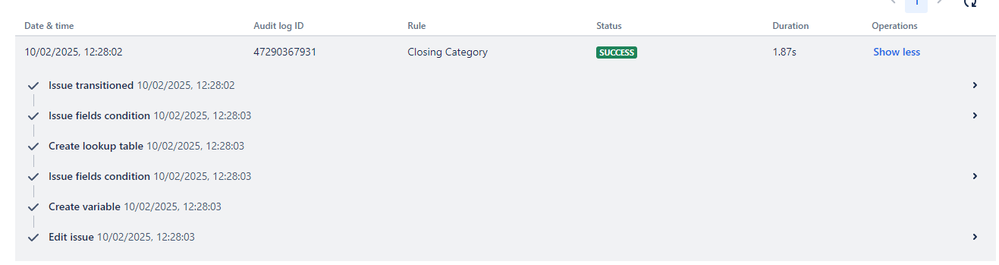

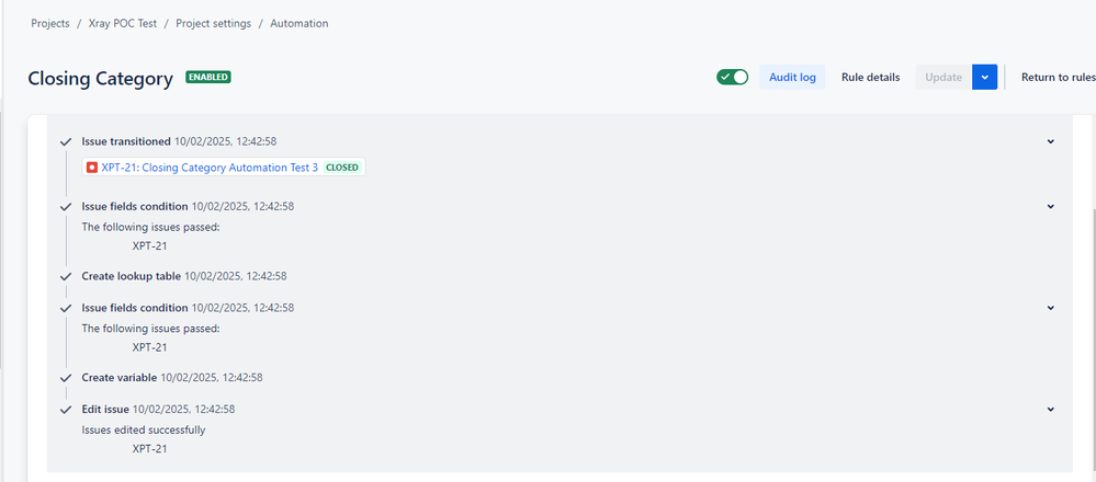

So the audit log is showing 'success'.
However, the Closing Category is still blank/none
This is good progress.

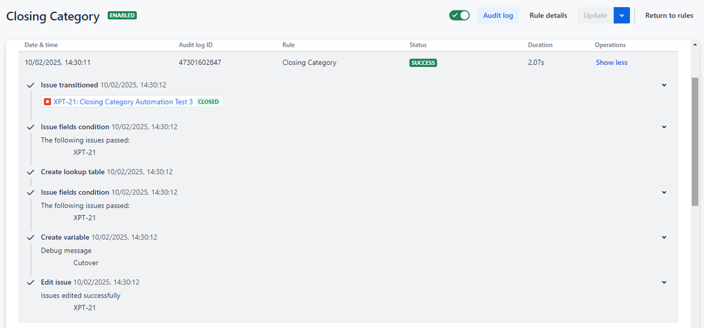

Can you expand the audit logs to understand where the issue is not meeting the condition?
Do validate that your case matches. Otherwise, string comparison may not work and hence field is not getting set.
Thank you for your patience with me :)
Here's the audit expansion. In the meantime I'll validate my case matches.
Looks like Root Cause variable is not getting value. Add more log statements to check where the conditions are failing and go from there.

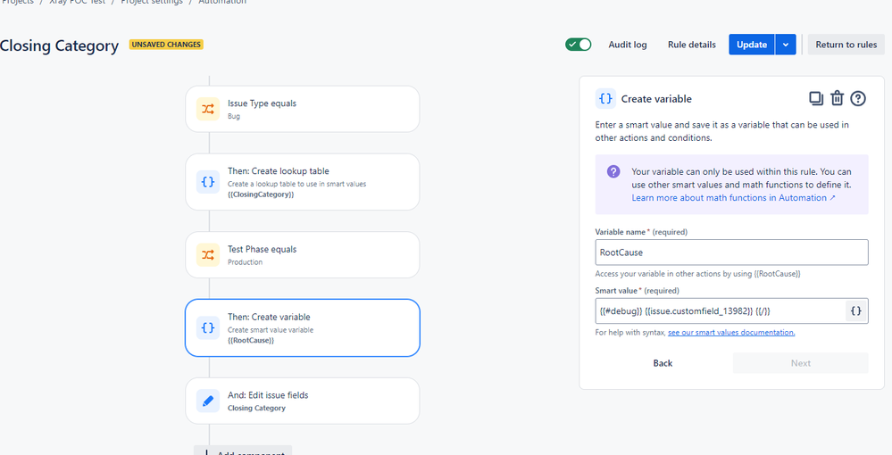

So wherever smart values are being created, enclose them in {{#debug}} {{/}
for example, for RootCause
{{#debug}} {{ ClosingCategory.get(issue.Helper Issue Creation) }} {{/}
When automation is executed and value is not getting set you know the problem
BTW, WHY are you using Helper Issue Creation, you need to give your custom field name. What i gave you was an example that i created based on available fields in my instance.
I haven't used Helper Issue Creation ?

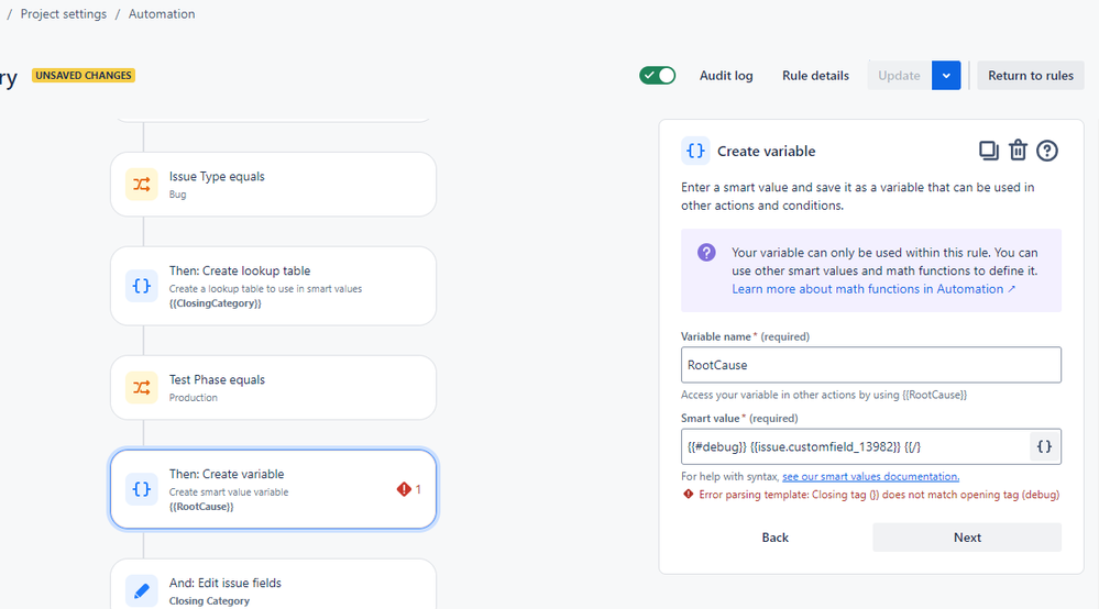

I've tried adding the debug here but am getting an error.
Add one more } at the end.
{{#debug}} {{ ClosingCategory.get(issue.Helper Issue Creation) }} {{/}}
Thank you. That's now worked.
This is the latest audit log, with the debug added.
Log shows you are getting Cutover as the value, so you are not using lookup table, while creating the RootCause variable.
Can you revisit your rule.

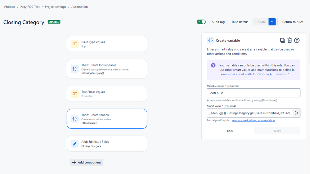

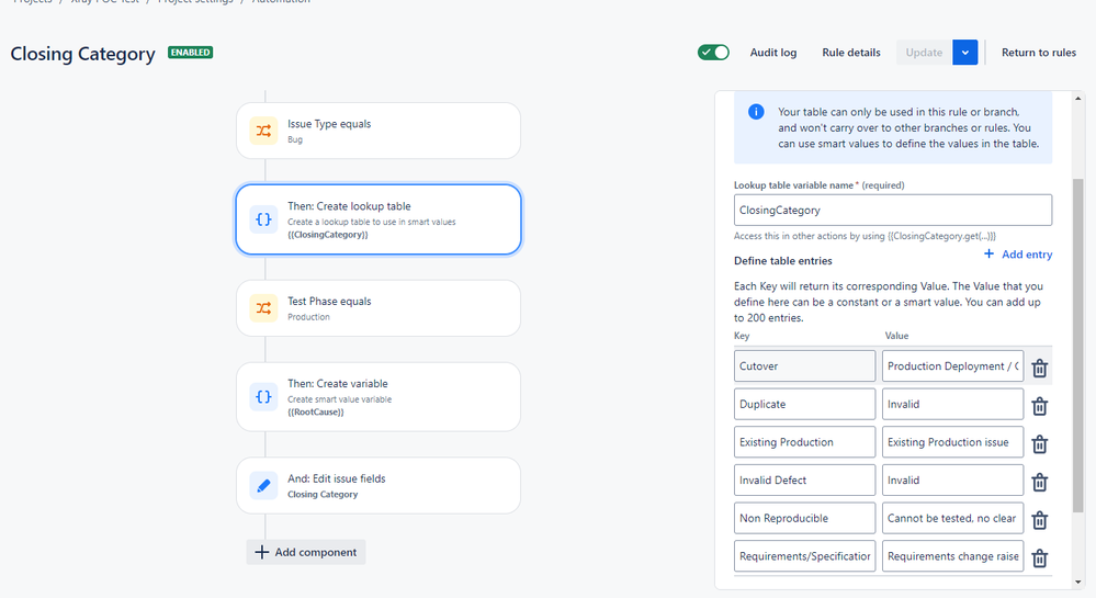

This is the table set-up. Is this not correct?

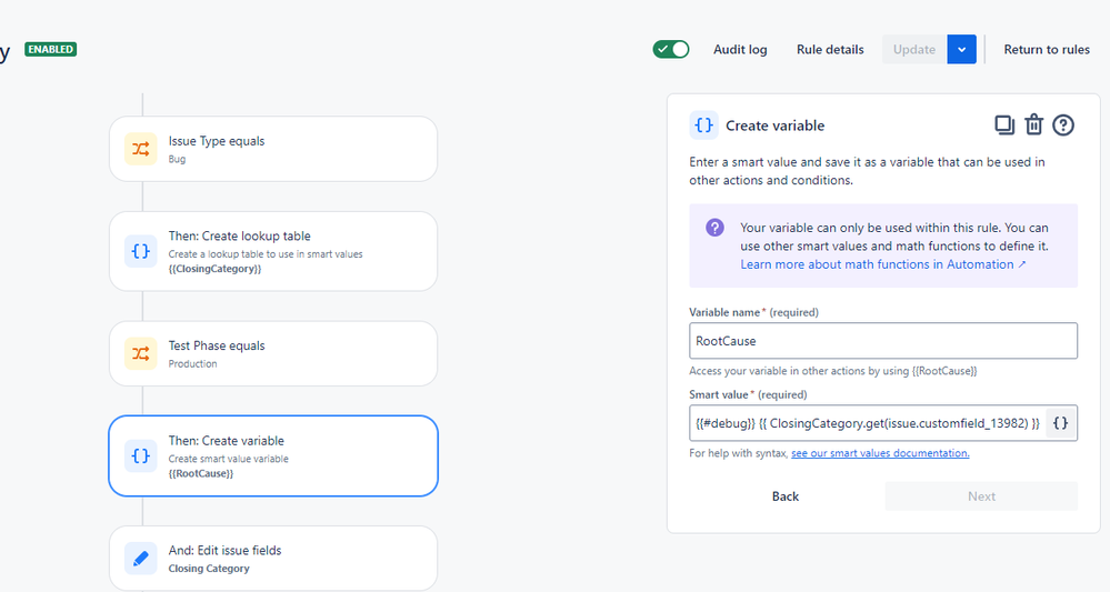

Table is fine. Check and share what you have in RootCause? it should be using the lookup table
it should be like this
{{#debug}} {{ ClosingCategory.get(issue.customfield_19832) }} {{/}}
I've updated it

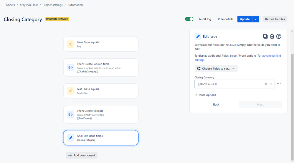

And re-run the automation with a new test bug issue. But the Closing Category is still not populating.

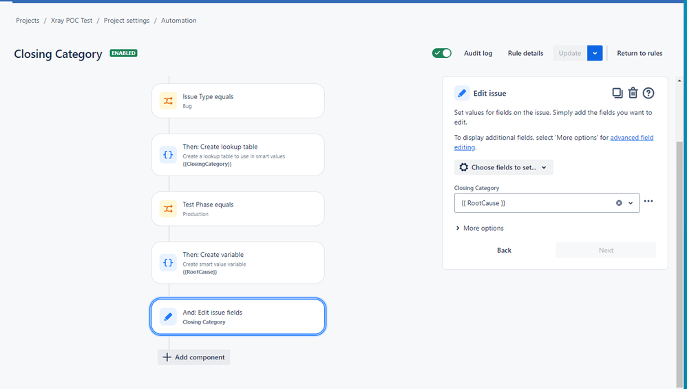

Can you share the SS of the last step i.e edit issue Field?
Also, share the history of what Updates happened after the automation was run
The only update since last running the automation was updating to this :
if you see the log message, RootCause is not getting value.
Add debug statement for issue.customfield_19832 to see what value it is having
I already have that in place for the variable. Do I also need to add it for the Edit issue fields?
add a log statement specifically for issue.customfield_19832
Need to see what else needs to be added to this variable to ensure it is picking right value

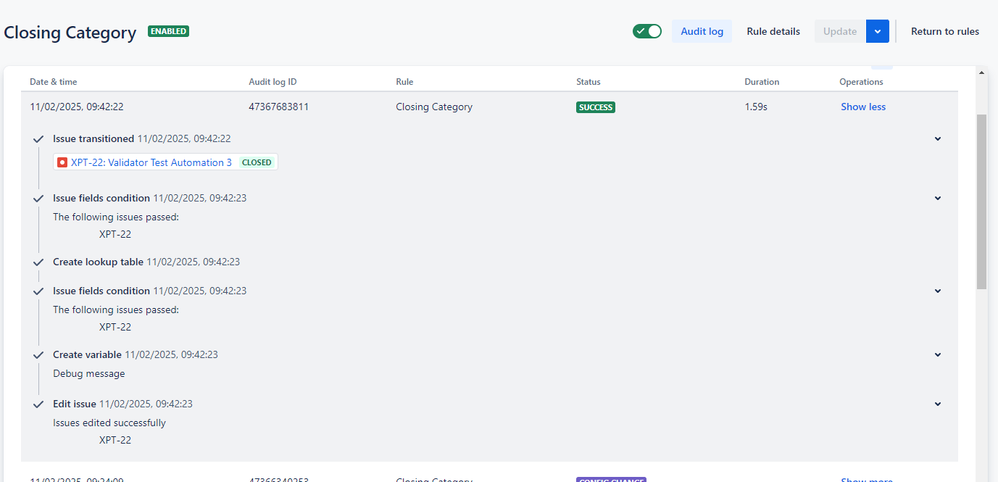

I performed a test: value in the customfield = Cutover and Test Phase = Production. I transitioned the issue from Fixed to Closed. The Closing Category remained blank.
Here's the automation log:
can you just add one more log statement and show what value is coming in {{issue.customfield_19832}}
