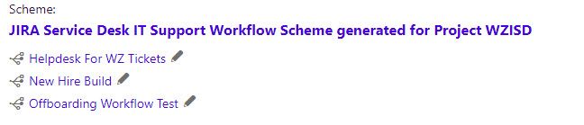

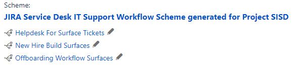

@Paul Kennedy - hi Paul! Ensure each project is truly using a different workflow?
Double-check each project. Go to their project settings (gear icon), then click Summary.
What workflow scheme is being used? If both are the same, you'll need a new workflow scheme, with the second one including the second offboarding workflow.
Paul Kennedy
May 14, 2021
Paul Kennedy
May 14, 2021
these are the workflow schemes set up for the 2 different projects
Like Dave Liao likes this
