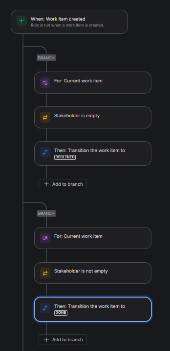

Apologies the format of above doesnt look great. I have included a screenshot to assist
Screenshot 2026-04-22 135534.pngNote I have used the field stakeholder for reference only. Please use the AD Attribute field you reference here

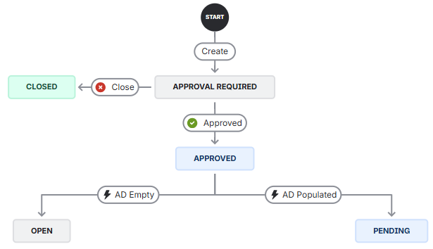

From your description, I'd suggest adding an additional transitionary status 'Approved':

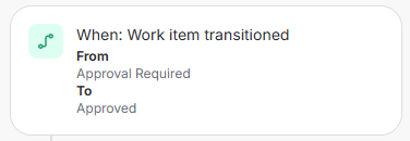

This is so the following trigger can be used:

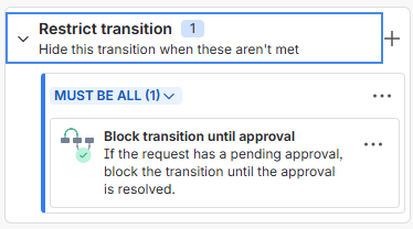

Make sure to use this restrict transition rule on the Closed and Approved transitions:

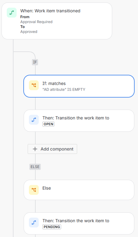

Doing this allows the following short automation to be used:
Note that after Approving the work item, the status of the work item will first change to 'Approved' before the automation kicks in and moves it to Open or Pending Information
