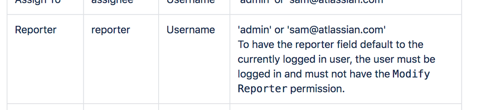

Thanks John. Unfortunately, your solution in 1 doesn't appear to be working for me. Also, I have seen that page to direct HMTL links, but it only suggests the following:
