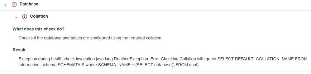

I recently upgraded Jira to a the latest version but the database seems to have a few issues. I get an error on my health check that says the following.

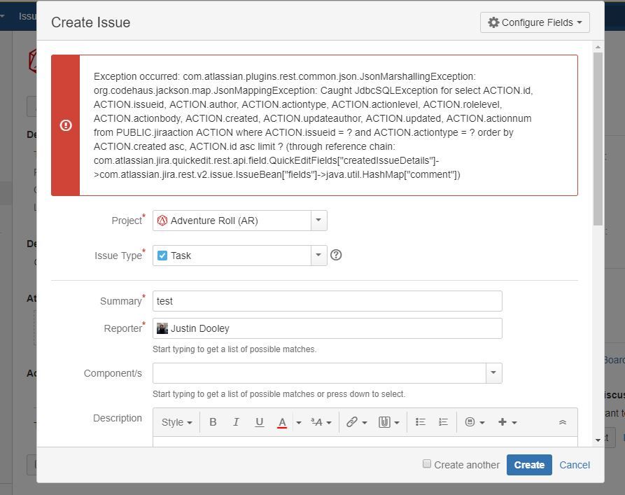

Capture.JPGThe strange part is that from mysql, the function runs correctly. The database is set to utf8 and the tables/columns are set to utf8_bin. I've verified this in the terminal. This does not stop new issues from being created. It just returns an error when quickly creating an issue.  The issue does get created if you refresh or navigate away though.

Hi Justin,
While it can be common to see this health check warning, that specific error you seen when creating an issue is not common.  In turn it could be an indication of other potential problems here.   I think it would be best to try to follow these steps as a means to make sure that your data and your database is using a collation/encoding that Jira is expecting.

Thanks for responding in the support case.  Before I could look at your update, it looks like you already found the solution.  Just in case other users might encounter this same problem I believe the issue was in regards to the dbconfig.xml had a <schema-name>PUBLIC</schema-name> tag in it.   This is appropriate for the H2 SQL database, but not for a MySQL database.   In turn it was forcing jira to try to use a database schema that wasn't really appropriate for that specific database.
Once that was removed, that file saved, and Jira started it appears this problem has been resolved.
