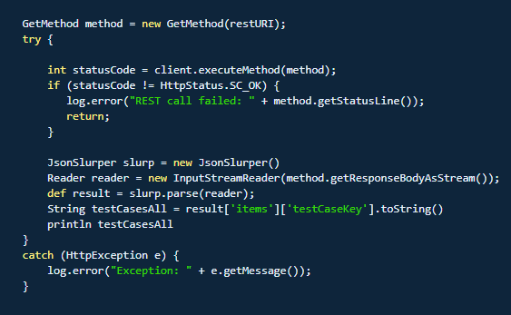

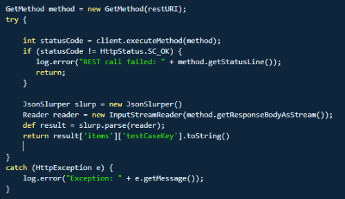

Hello @Tansu Akdeniz !

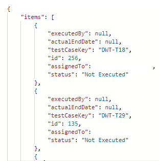

I've been trying to use your code in ScriptRunner to make a GET request from an outside API, however I can only get the response to show up when I'm returning it. If I want to assign the result to a variable (which I will need in order to split, trim, etc.), I get 'null' as a result. Do you perhaps know how to make this GET request so that I get a JSON object which then I can use to extract values from? (I'm very new to this.)
This is the response I want to extract the values (precisely the testCaseKeys) from:
This is my code. The first one works and gives me the response I want to work with and the second gives me null.
Thanks so much!
Tansu Akdeniz
March 4, 2020
Hi @heysunny ,
Can you please try this one?
def parsedResult = result."items"
return parsedResult
