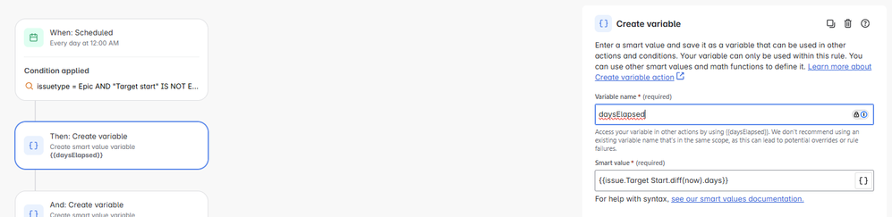

In a scheduled automation, I am trying to calculate the difference between the current day and the Target Start day.  The automation runs successfully, but the variable that I am trying to put the value into is blank.  Any suggestions?  Here is the Smart Value I am using:
{{issue.Target Start.diff(now)}}
I have confirmed that I can move both values (issue.Target Start and now) into variables successfully.  I've also tried to use those variables as a work around but no luck there.
Any ideas are greatly appreciated!

Can you please provide screen images showing the entire automation rule?
What is the field type for Target Start? Is it a Date field, Date/Time field, or something else?
One thing that I notice is that you did not specify the unit for output. Do you want weeks, days, hours, ...?

I'm looking for the field definition for Target Start, but it is the default field type used by Advanced Roadmaps.
Good catch on the unit. I updated accordingly and unfortunately still no luck there ({{issue.Target Start.diff(now).days}}).  Same results.
Does this give you what you were looking for?
