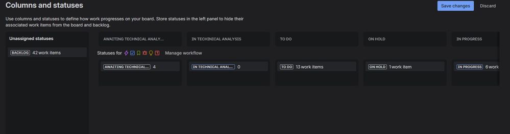

We are using a Jira Cloud Kanban board.
In an older domain, the Kanban backlog works as expected without a Backlog column (backlog = issues not yet added to the board).
However, in a newly created domain, the behavior is different:
  • Issues in Backlog status do not appear in the backlog
  • Issues already added to the To Do column appear in the backlog list
The board filter configuration is identical.
This suggests a possible change in the default Kanban backlog behavior for new Jira Cloud sites.
Is this an intended or known change?

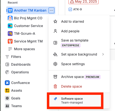

Can you confirm that both of these boards are in Jira Cloud environments?
What is the Space type for each of the Spaces shown in these images?
To find the Space type, click on the three-dots button next to the Space name in the navigation panel on the left. In the pop-up that displays the Space type is specified in the last two lines. Both lines are necessary to understand the Space type.
I am assuming that this relates to Software spaces.
The behaviour of the column mapping and Backlog will differ between Company-managed and Team-managed projects.

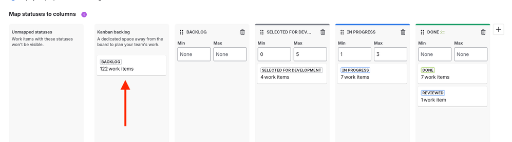

With Company-managed projects an issue will be in the Backlog list on the Backlog screen based on its status, and you designate those by adding the Status to the Kanban Backlog column in the Columns and Statuses page:
In a Team-managed project the issue Status is NOT used to designate if the issue should be in the Backlog list or on the Board. Issues in any status can be in either the Backlog list or on the board.
In both cases if you move a status to the Unassigned Statuses column you are telling Jira that you do not want to display issues assigned to that status anywhere; neither in the board nor in the Backlog.
I suspect that you are working with a Team-managed board in your new environment, if the black-background image is for the board where

We intentionally do not want to create a dedicated Backlog column on the Kanban board.
All statuses are expected to remain under Unassigned statuses.
Our expectation is:
  • Issues with Backlog status should appear in the Backlog page, under the Backlog section.
  • Only issues in Backlog status should be listed there.
  • Issues in To Do category (or any other category) should not appear in the Backlog list.
This is how the backlog behaves on our older Jira Cloud site with the same Kanban setup.
Could you please confirm whether this behavior is still supported for Kanban boards on newer Jira Cloud sites, or if mapping statuses to a Backlog column is now mandatory?

Normally, on a Kanban board, you can activate a backlog by adding statuses to the Kanban backlog column (Board setting -> layout -> coloumns) . Then the Backlog menu will appear, showing only tickets with the mapped statuses.
Can you provide few screenshot (board setting columns and backlog board ) ?
On a Scrum board, the backlog contains all tickets regardless of their status, and the active sprint shows tickets by column based on the mapped statuses

Hatice Kübra Demirbaş
January 16, 2026
Hi @Duc Thang TRAN ,
Thank you for the clarification.
Both boards are indeed Kanban boards (not Scrum), and their filters and column mappings are identical.
What caused the confusion is that, in the older Jira Cloud site, the Kanban backlog behaves as “issues not yet on the board,” regardless of status, without requiring any statuses to be mapped to the backlog column.
In the newly created site, the backlog behaves strictly according to Kanban status-to-column mapping, as you described.
This is why we were wondering whether the older board’s behavior was legacy, non-standard, or the result of a configuration or historical change in Jira Cloud Kanban backlog behavior.
If there is a way to confirm whether the older behavior is expected, deprecated, or configuration-driven, we would appreciate the guidance.
January 16, 2026
Hi
I’m using a Kanban board and intentionally rely on the backlog to show issues not yet added to the board, without using a Backlog column.
In an older Jira Cloud domain, this setup worked as expected:
  • Issues in Backlog status appeared in the backlog
  • Issues added to the To Do column did not appear in the backlog
I’ve checked Columns / Status mapping: there is no Backlog column, and other statuses are correctly mapped to their columns.
Has the default Kanban backlog behavior changed in new Jira Cloud domains, or am I missing a setting?
