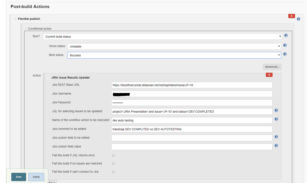

Nikola Velevski
October 4, 2017
HI,
Maybe anyone could help me with this.
I want automatic transition on Jira Issue J-10, depending on the current build status in Jenkins. For example If the build in Jenkins is successful then I want Jira issue to transit in status DEV AUTOTESTING.
I am using the Flexible Publish Plugin, in the part Post Build Actions
And when I make a build in Jenkins this error is shown.
Unable to connect to REST service
java.io.FileNotFoundException: https://itssoftvercentar.atlassian.net/rest/api/latest/issue/JP-10.json/search?jqlFinished: FAILURE
Bellow is given a print screen from Jenkins. Is this the right way?
Ravindu Kumarasiri
February 6, 2018
I haven't done this way. But I have tried with the Multi Branch Pipeline. For your case by setting the Issue Pattern as (J-[1-9][0-9]*) should pick the issue ID from the commit and update the issue.
NOTE: You need to have the Jenkins Add-on in JIRA for this to work. One more thing. Add the Jenkins to JIRA after adding the plugin from Settings->System->Application->Jenkins Configurations

redlin6688
June 8, 2023
it seems that your JIRA REST Base URL is not corrent, I think just the jira base URL is ok
