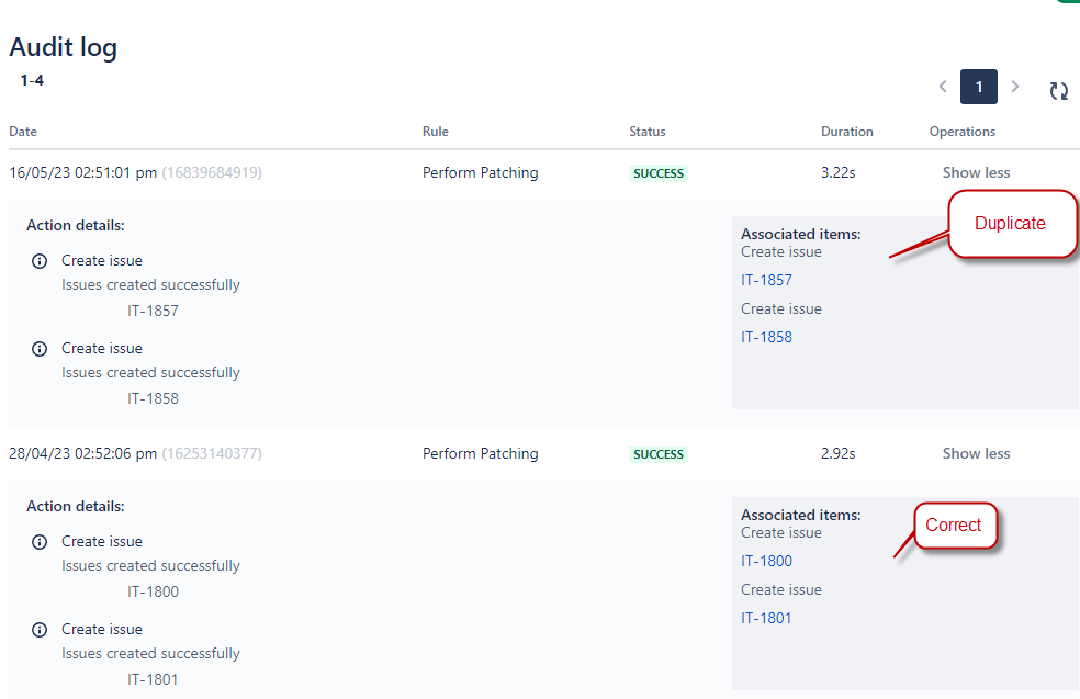

Hi @Yufang Vangaasbeek
Can you post a screenshot of the audit log around the time the automation created the second task and subtask?
It would give me a bit more information to work off of.

Yufang Vangaasbeek
May 16, 2023
Yufang Vangaasbeek
May 16, 2023
@Ash Yadav  See attached!
Ash Yadav
May 16, 2023
Thanks!
Not a whole lot to go off of here, but it fired the same rule successfully which leads us somewhere.
Any chance you could post the automation rule so I can look into it a bit more?
Maybe there is something there causing it to fire twice.

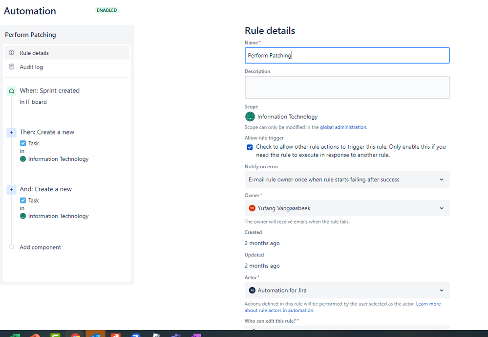

Yufang Vangaasbeek
May 16, 2023
Ash Yadav
May 17, 2023
Thanks for sending that on.
@Bill Sheboy  has highlighted some important points above that could shed some light on this.
In addition to this, is there any specific pattern as to when the rule fires a second time?
e.g. Exactly 2 weeks from the first one.
KR,
Ash

@Bill Sheboy @Ash Yadav Great questions. I don't have dependencies with this automation regarding another automation. It sounds like I need to turn off the 'allow rule trigger', right?
This is the first time it has happened and the first 'month' that we initiated this automation. It looks like it triggered on the 18th day.
The IT scrum board is the only automation rule I have for this type of trigger.
