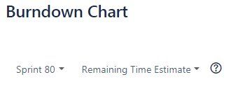

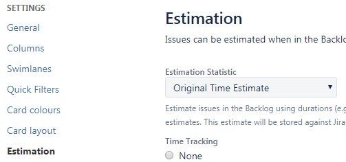

Just to confirm 2 settings :
When you're on the Burndown page, is the dropdown set to Story Points?
If you go to Board settings and click on Estimation, is the dropdown set to Story Points?
