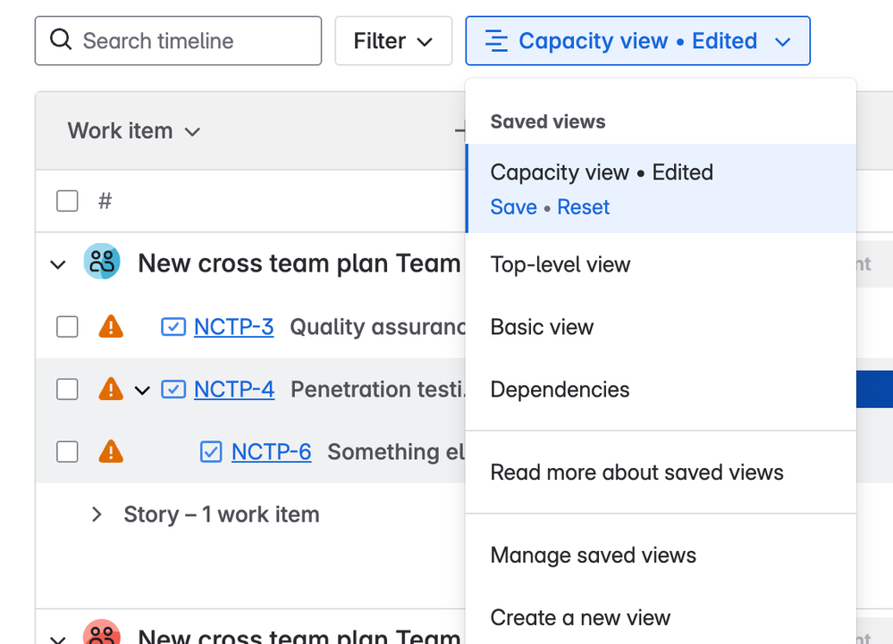

Hi Felix,
In Plans you should be able to see the Views menu. To persist the changes to the view you're seeing so that the other user sees the same things, you'll need to open it and hit "Save" to save the changes to the current view.
Here's some documentation on the subject if you'd like to read more about it.
https://support.atlassian.com/jira-software-cloud/docs/save-a-new-view-in-advanced-roadmaps/
Felix Leung
May 12, 2025
Thanks, I tried Save view but no luck. However, when I use Save As a new view, it works!

Mendel Liang
May 12, 2025
Ah, I didn't realise you were using the Data Centre version - yes, you'll have to use the meatball menu next to the views dropdown to save changes to your view or save changes as. The relevant documentation is here https://confluence.atlassian.com/jirasoftwareserver/modify-a-view-in-advanced-roadmaps-1044784239.html
Glad to hear that you've got it working now!
