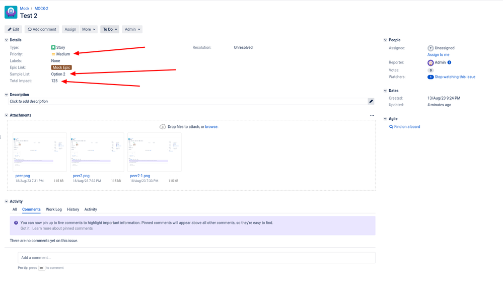

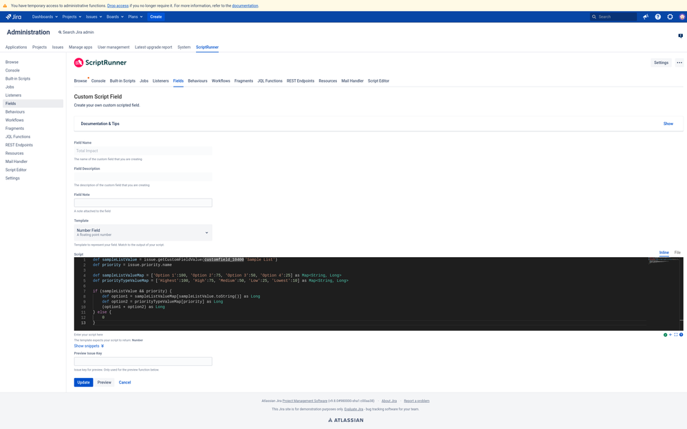

Below is a screenshot of the Scripted Field configuration:-

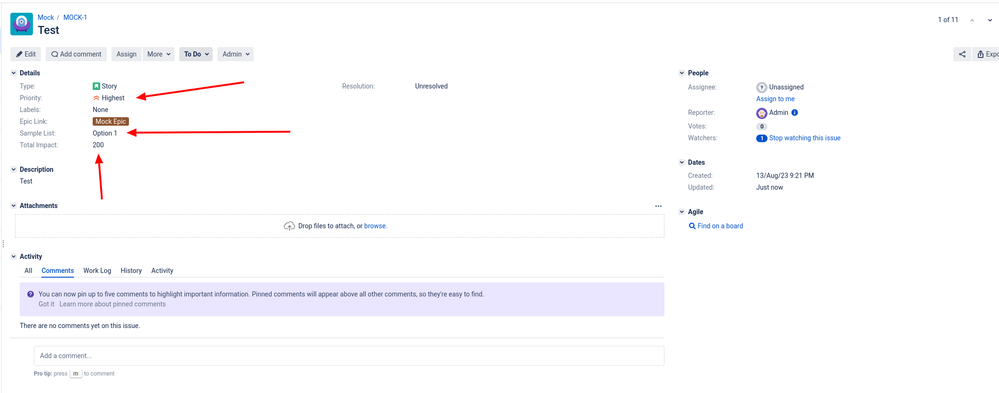

Below are a couple of test screenshots for your reference:-
As you can see in the screenshots above, when the option from the Single Select List and Priority fields are updated, the value of the Scripted Field is updated accordingly.

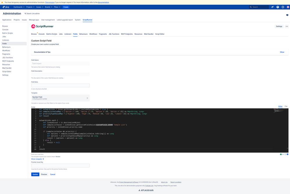

If you are trying to get the total impact from linked issues, you need to follow the working code below:-
def outwardLinks = issue.getOutwardLinks { excludeSystemLinks = true }
def sampleListValueMap = ['Option 1':100, 'Option 2':75, 'Option 3':50, 'Option 4':25] as Map<String, Long>
def priorityTypeValueMap = ['Highest':100, 'High':75, 'Medium':50, 'Low':25, 'Lowest':10] as Map<String, Long>
def result
outwardLinks.each {
def linkedIssue = it.destinationObject
def sampleListValue = linkedIssue.getCustomFieldValue('Sample List')
def priority = linkedIssue.priority.name
if (sampleListValue && priority) {
def option1 = sampleListValueMap[sampleListValue.toString()] as Long
def option2 = priorityTypeValueMap[priority] as Long
result = (option1 + option2) as Long
} else {
result = null
result
Please note that the sample working code above is not 100% exact to your environment. Hence, you will need to update it accordingly.

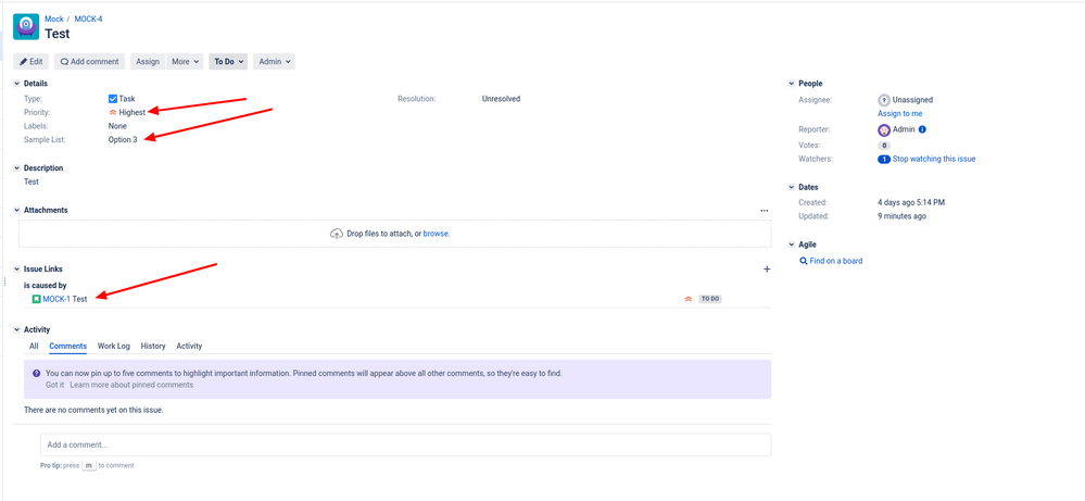

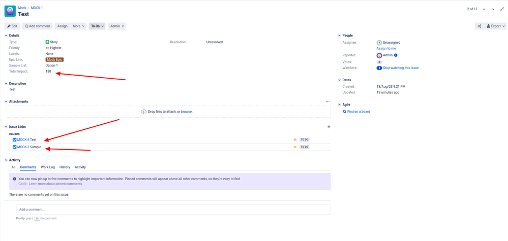

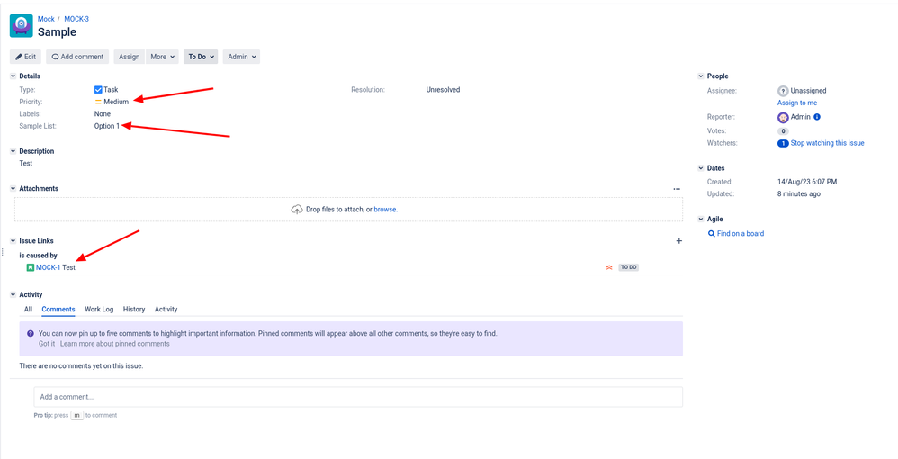

Below is a screenshot of the updated Scripted Field configuration:-
Please also ensure that you update your ScriptRunner plugin to the latest release, i.e. 8.9.0 or at least 7.11.0, so you can make use of ScriptRunner's HAPI feature to simplify your code.
I hope this helps to solve your question. :-)
