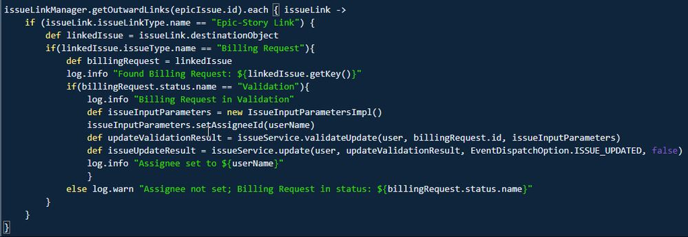

EDIT: Not sure why the formatting is so bad... here's a screenshot of the same code more readable:

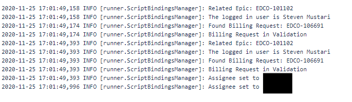

Here is the output from the log on success:Screen Shot 2020-11-25 at 5.12.51 PM.png
Why is log data being posted for the iteration's that failed? Since they are nested within the IF statement, wouldn't this only have one line per success which is exactly one issue in my test case? I don't understand why I would have so many lines in the log on a success. Failure seems to log as expected.

Any chance you actually have 2 identical links between those two issues?
Maybe add a line at the top of your "each" block:
log.info "Examining issues link with id=$issueLink.id"
If you have a different id before each of the successes, that should give you a clue.
